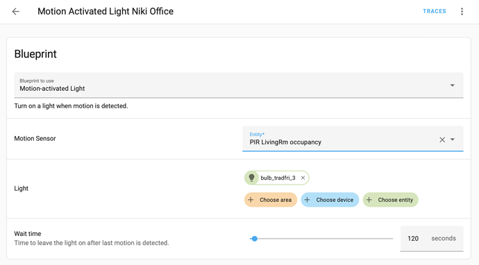

Hi Edward, I am using the standard one from HA (homeassistant/motion_light.yaml).
When I create an automation from it, it looks like:
I have looked into this file but I have no clue what I need to add in order to add the conditions.
Hence I was hoping someone did this already (I think this is a pretty obvious desired extension)
