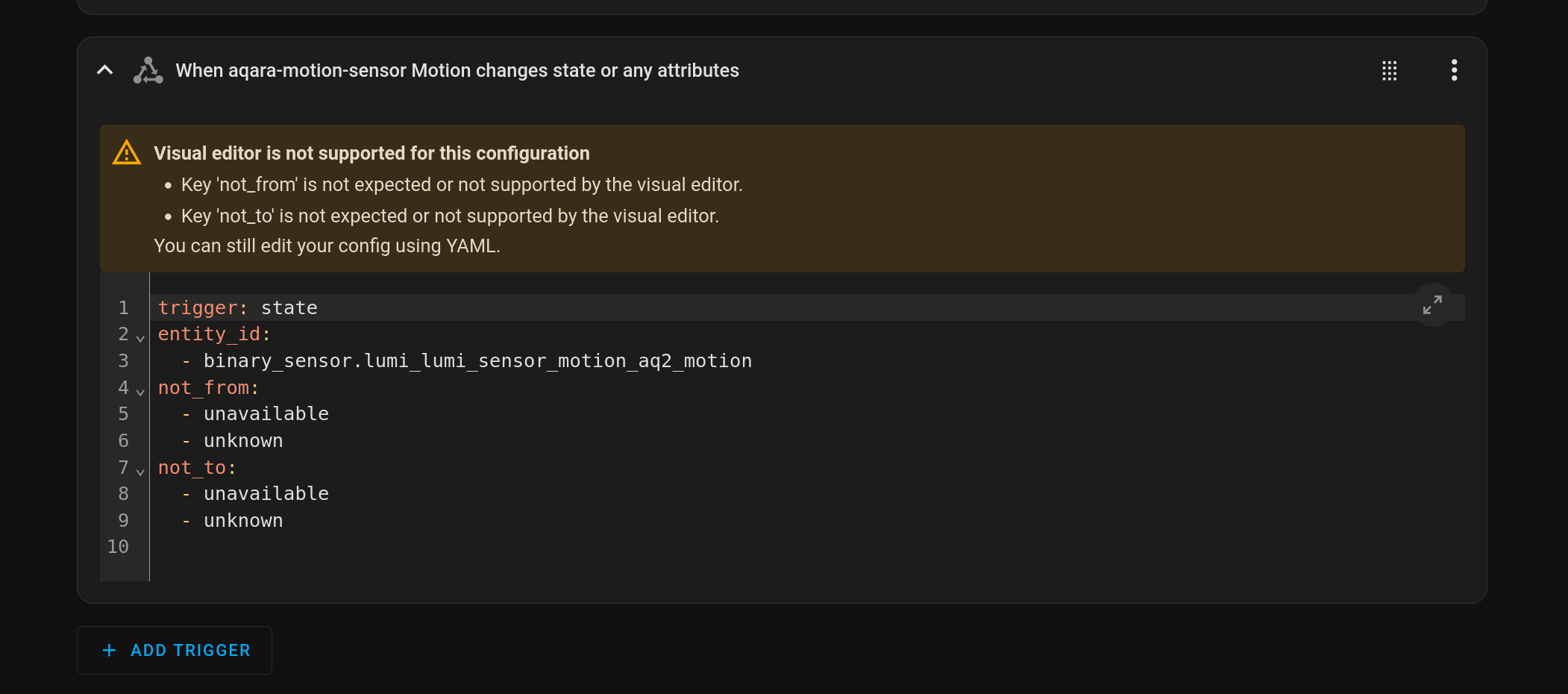

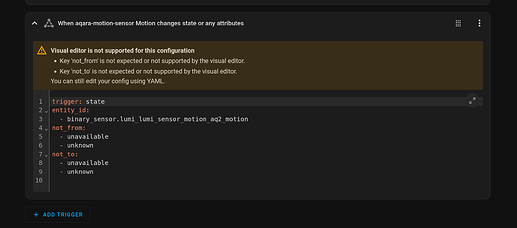

ok I changed first trigger to:
Visual editor is not happy, but looks like automation still works!
I would never figure out to add not from and not to there.
It’s only possible in yaml mode?
