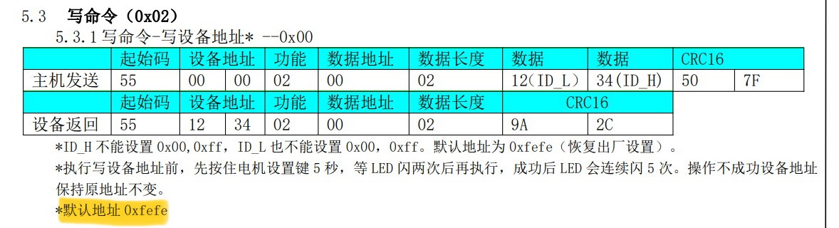

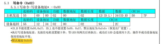

Try 0xFEFE, should work i think

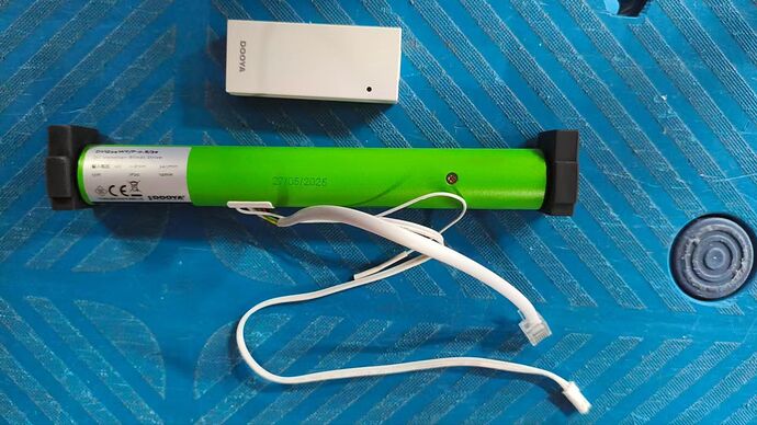

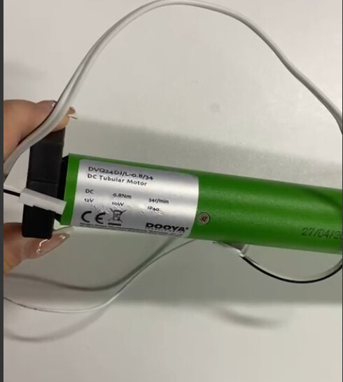

I am at the same boat now. Ordering 10k worth of venetian blinds with this motor as only wired option DVQ24WF/P-0.8/34.
The other motor they offered doesnt have serial port jack, which they refer as battery operated DVQ24AF/L-0.8/34 and DVQ24DJ/L-0.8/34
Supplier offered me these Serial converter boxes and was wondering which one to choose. I was thinking between tuya DC1545V and zigbee DC1545R.
