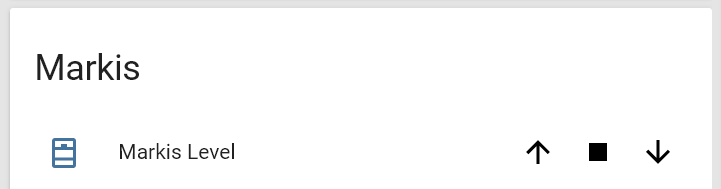

Can anyone suggest a good card to control the lift/drop? I used a button card, but the up/down arrows you see on cover entities might be cool. I dont know how to create that tho.
Any suggestions welcome
