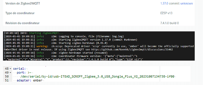

Following the upgrade to 7.4.2.0 firmware of my Sonoff Zigbee Dongle E I always have this in the z2mqtt log :
zh:ezsp: Deprecated driver ‘ezsp’ currently in use, ‘ember’ will become the officially supported EmberZNet driver in next release. If using Zigbee2MQTT see Improved Ember (EZSP) driver (experimental) · Koenkk/zigbee2mqtt · Discussion #21462 · GitHub
I tried to change from ezsp to ember in the configuration.yaml I 've got this :slight_smile:
Then after restarting z2mqtt though the file is ok the view from the z2mqtt module is still in ezsp, and I still got the same message in z2mqtt log :
When I’m trying to change it from there to ember it reverts back to ezsp. What can I do ?

Found out that I had to go in z2mqtt module information (where you can stop/ restart it from there there you can set the settings regarding the interface after writing ember and a restart I’m now with ember
where did you find this option?
If I go to the zigbee2mqtt web UI, click the gear icon, go to settings, and go to the serial tab, then there’s a dropdown menu for adapter type. If I change it to ember and hit submit, it immediately changes back to ezsp. That’s the only place I’ve found this setting other than the zigbee2mqtt configuration.yaml.
It is in the Addons page - click on Zigbee2MQTT tile. Then click the configuration tab at the top.
There are 3 places to edit this - and this is the only one that seems to work.
  1. The Cog on the Zigbee2MQTT webUI - as you say resets immediately
  2. Edit it in the config file - updates (sometimes) but has no effect in practice
  3. In the Addons menu - that is where it works (after restart)

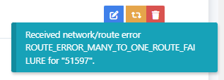

Got a lot of new error messages tough… Does anyone know what they mean?
could it be possible there are still some reminants of the “ezsp” in my network?
Very few (2 out of 62) nodes are not responsive anymore. In the error message there is a mention of “EZSP”, where I am currently on “ember”.
Or maybe just a coincidence?
Maybe try to re-pair those.
