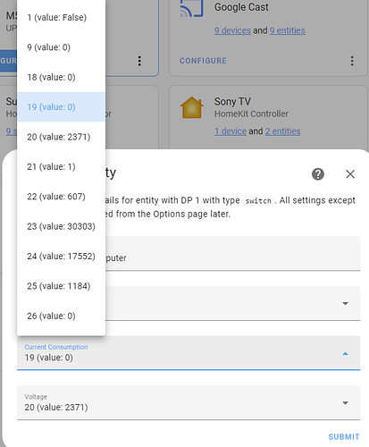

Now trying to add in local:
Voltage seems ok, there’s no matching values for the rest
It’s added as a switch, changed to an outlet and still no sensors:
