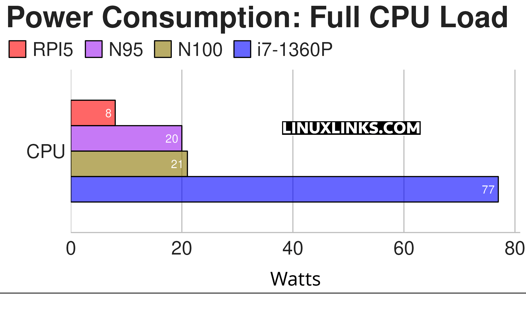

Below shows a comparison of pi vs various intel nucs while cpu is under a load.
Test perfomed by linuxlinks.com not my own image
Is it true the intel nucs pull more power? Yes.
Is it worth sticking with pi for saving 12watts? No, not in my opinion.
Lets look at the true cost of upgrading from pi to intel nuc if your electric cost was $0.3855 per kwh (including all the itemized cost Con Edison cons us with).
Daily cost (24/7 @ full CPU load) — price: $0.3855/kWh
Device       Watts   kWh/day    Cost/day   Chart ($0.10/block)
RPI5             8     0.192        0.07   █
N95             20     0.480        0.19   ██
N100            21     0.504        0.19   ██
i7-1360P        77     1.848        0.71   ███████
Monthly cost (31 days @ full CPU load) — price: $0.3855/kWh
Device         kWh/31d    Cost/31d   Chart ($1/block)
RPI5             5.952        2.29   ██
N95             14.880        5.74   ██████
N100            15.624        6.02   ██████
i7-1360P        57.288       22.08   ██████████████████████
Assumptions & formula
Electricity price: $0.3855 per kWh
Daily cost  = (Watts / 1000) * 24 * $0.3855
31-day cost = Daily cost * 31
Notes: based on the image’s “full CPU load” power (RPI5=8 W, N95=20 W, N100=21 W, i7-1360P=77 W).
Real-world idle/boost, PSU efficiency, and peripherals can change results.
