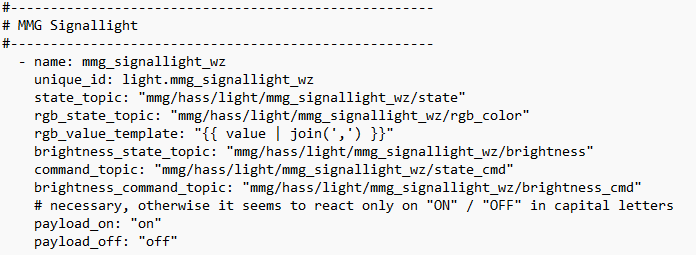

Reading MQTT Light - Home Assistant I’ve configured a MQTT Light like this:
  - name: mmg_signallight_wz
    unique_id: light.mmg_signallight_wz
    state_topic: "mmg/hass/light/mmg_signallight_wz/state"
    rgb_state_topic: "mmg/hass/light/mmg_signallight_wz/rgb_color"
    brightness_state_topic: "mmg/hass/light/mmg_signallight_wz/brightness"
    command_topic: "mmg/hass/light/mmg_signallight_wz/state_cmd"
    brightness_command_topic: "mmg/hass/light/mmg_signallight_wz/brightness_cmd"
    payload_on: "on"
    payload_off: "off"

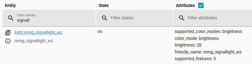

On/Off and brighness work (are shown in light.mmg_signallight_wz), but the color isn’t.
rgb_value_template: "{{ value | join(',') }}"

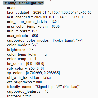

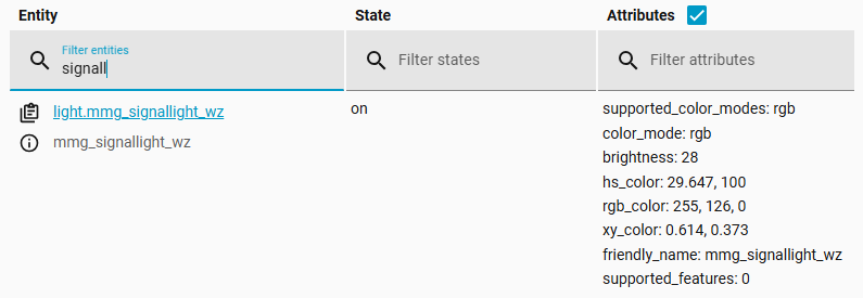

Testcase:
Turning on the light in the remote installation, which publish its states to a MQTT-Broker via MQTT Statestream.
This is the view on the broker:
rgb_color is set (to Red).
brightness is 28, so it’s on.

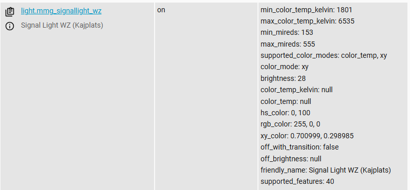

Another HASS instance subscribes to the MQTT broker with this mqtt light config:
The light entity gets created on this instance and follows the on/off and brightness states, but no RGB attribute is generated for this entity:

I have spent a few hours experimenting with MQTT Light and have come to the conclusion that it is subject to some, to put it politely, misbehavior.
The issue appears to be related to the supported_color_modes option as shown in your screenshot here:
In my testing, I got the same brightness value and once that particular value was set, Home Assistant refused to support any rgb-related options (it posted warnings and errors in Logs so I advise you to check your Logs as well).
If the value is rgb then it will support rgb-related options. However, there is no way to manually set the value of the supported_color_modes option for the default (basic) light schema (it can be done for the json schema).
Home Assistant appears to infer the value based on what it detects in the MQTT Light’s configuration. However, if the light’s configuration contains rgb-related options but Home Assistant has trouble interpreting them, it defaults to setting supported_color_modes to brightness.
Worst of all, some of the error messages I received suggested it was not even trying to use rgb_value_template. For example, the error message contains the value [255, 252, 71] and was not able to process the leading square bracket.

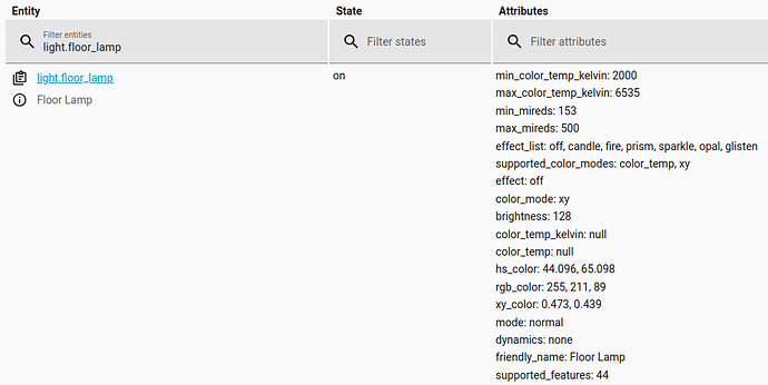

After more experimentation, I have succeeded in creating an MQTT Light configuration that correctly reports the state, brightness, and RGB values published via MQTT Statestream.

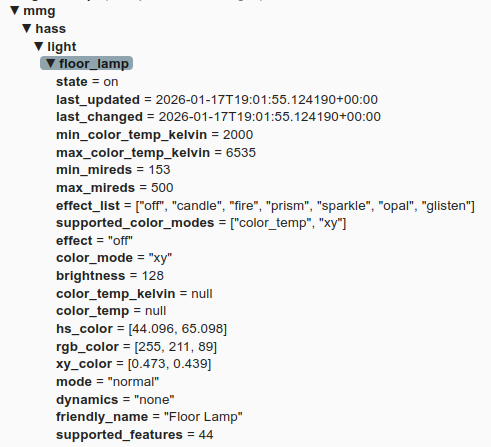

Here is light.floor_lamp which is a Philips Hue light integrated to my main Home Assistant server via the Philips Hue integration.
My main server uses MQTT Statestream to publish light.floor_lamp’s information via the following topics and payloads (screenshot from MQTT Explorer).

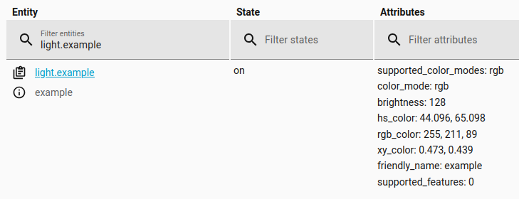

On my Home Assistant test server, I have the following MQTT Light configuration for light.example.
mqtt:
  - light:
      unique_id: example_123
      state_topic: mmg/hass/light/floor_lamp/state
      state_value_template: "{{ value | upper }}"
      command_topic: mmg/hass/light/floor_lamp/state_cmd
      brightness_state_topic: mmg/hass/light/floor_lamp/brightness
      brightness_value_template: "{{ 0 if value == 'null' else value }}"
      brightness_command_topic: mmg/hass/light/floor_lamp/brightness_cmd
      rgb_state_topic: mmg/hass/light/floor_lamp/rgb_color
      rgb_value_template: "{{ value[1:-1] if value != 'null' else '0,0,0' }}"
      rgb_command_topic: mmg/hass/light/floor_lamp/rgb_color_cmd
The important thing to know is that the MQTT Light integration handles the payload values as strings. For example, [255, 211, 89] is shown in MQTT Explorer as a list but the MQTT Light integration handles it as a string. The same is true for null which is handled as a literal string and not the null object (i.e. none). Knowing this is vital for creating valid templates to process the values.

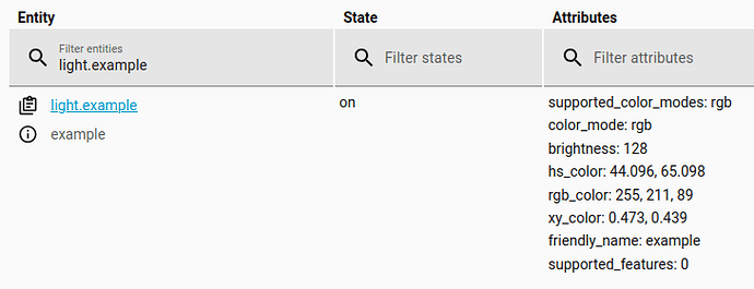

Finally, here is the resulting light.example reporting the same state, brightness, and RGB values of light.floor_lamp.
