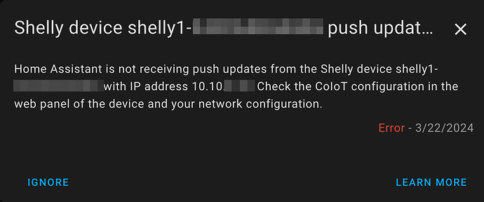

I tried id now with one 1pm and it worked BUT I get an error in HA which says that CoIoT-Config is not working. But I have it activated.
What do I have to do ?
That is the Shelly integration, not MQTT
Mhhh, did I misunderstood something ?
I activated python scripts and put in the shelly script from link above and then I found the 3 devices.
I connected one shelly 1pm device and this message appears :frowning: What did I do wrong ?
The shelly 1pm device is one of the 3 devices, or a new one ?
No the three devices are connected still to my external mqtt server but not in the mqtt session:
So the shelly integration discovered the shelly 1pm, did not see CoIoT, and warns it needs CoIoT to be able to integrate it.
Yes but in the shelly the ColoT is activated to my external mqtt server so why does HA not see it ?
Do you run the script on HA start ?
