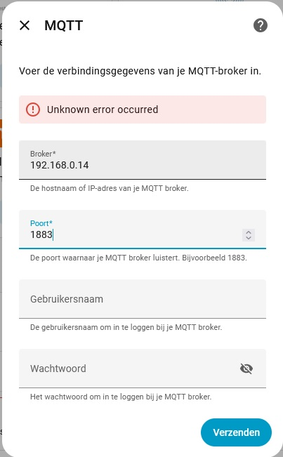

Thanks Rick, seems like a good plan! First problem on the way: when trying to connect to my existing mosquito broker on another Rpi, I get the message “Unknown error occurred”. I can listen to that mqtt broker with MQTT explorer, so it is definetely up and running. No password needed either. Any idea what is wrong? Must add that I am running HA in docker on a Rpi.
The MQTT add-on doesn’t allow anonymous connections. I realize you’re not running the addon but instead running MQTT as a stand-alone docker container, but I mention this just to highlight that you should check to ensure there isn’t a special configuration that is needed (both on the docker container as well as the HA integration) to allow anonymous connections. If it were me, I’d add a user/password just to eliminate that as a potential problem, even if only temporarily for troubleshooting.
Another thing to verify is that HA and the MQTT container are networked together on the same subnet and can ping each other.
This tripped me up as well. I had been running Mosquitto on a Raspberry Pi3 for five years without a password. I discovered this annoyance when the Raspberry started failing slowly and I added the Mosquitto add-on. Just use your Home Assistant name/password. (Easier to remember).
Hello Rick, thanks for the advice. The error came because the Rpi was out of memory. I had 2 containers on a 128 Gb SD-card, 1 for HA and another for Domoticz, because I want to migrate from Dz to HA. The file manager said: 117 Gb available, 0 bytes free. So I removed the DZ container, which was there only for testing purposes and now I have 63 Gb free memory. The Mqtt integration went flawless. Second problem: Following your advice for the mqtt trigger, I added two automations to the configuration.yaml for testing:
