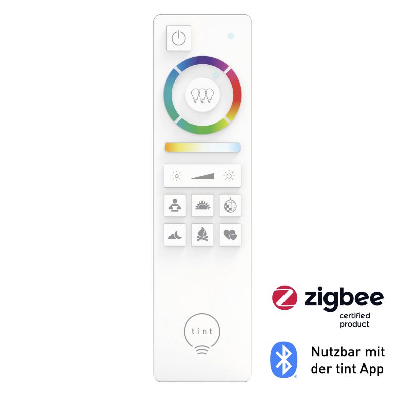

This is a Home Assistant automation blueprint to control lights using the Müller Licht 404049D dim remote via Zigbee2MQTT. The blueprint utilizes MQTT triggers to handle button presses and provides configuration options for common actions like turning lights on/off, adjusting brightness, and cycling scenes.

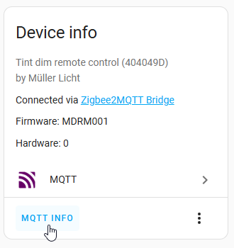

  1. Ensure Zigbee2MQTT is set up and publishing MQTT messages. You may check the device logbook for incoming actions in Home Assistant.
  2. Note the MQTT topic for the device (e.g., zigbee2mqtt/muller_licht_remote).
