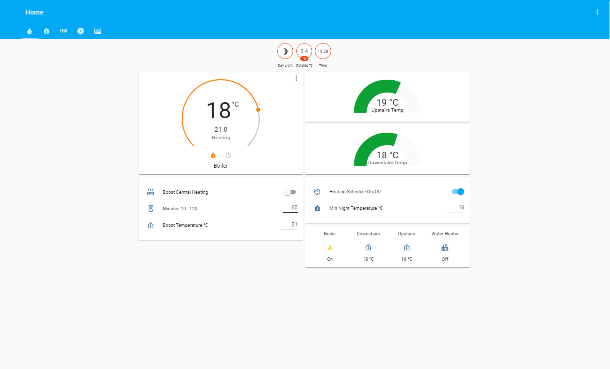

Multi Zone Heating now with 7day scheduling
Features
  • 7 Day timer
  • 8 Time Slots per day
  • Min Temperature / night temperature.
  • Multi Zone Heating
  • Boost timer for Central Heatring and Hot Water Immersion Heater
  • Solar Hot Water Monitoring
  • Auto Immersion Boost if shorfall in hot water from solar / CH at selected time
This is a continuation of my previous project found here: https://community.home-assistant.io/t/multi-zone-heating-with-scheduling/160280
I’d welcome any suggestions on improvments that could be made to this project.

      - cards:
          - entity: climate.ha_thermo
            type: thermostat
          - entities:
              - entity: input_boolean.switch_boiler_timer
                name: Boost Central Heating
              - entity: input_number.boiler_timer
                name: Minutes 10 - 120
              - entity: input_number.temp_boost
                name: Boost Temperature °C
            type: entities
        type: vertical-stack

          - entities:
              - entity: input_boolean.heating_master
                name: Heating Schedule On/Off
              - entity: input_number.t0_temp
                name: Min Night Temperature °C
            show_header_toggle: false
            type: entities
          - entities:
              - entity: switch.700574032462ab3b7e49
                icon: 'mdi:fire'
              - entity: sensor.current_temp
                icon: 'mdi:home-thermometer-outline'
              - entity: sensor.upstairs_temp
              - entity: switch.bfd019f305520a0591hgke
                icon: 'mdi:hot-tub'
            show_name: true
            show_state: true
            type: glance
    icon: 'mdi:fire'
    path: default_view
    title: Central Heating

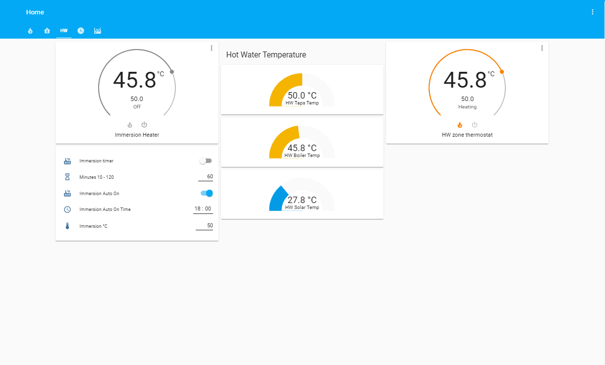

      - entity: climate.hw_thermostat
        type: thermostat
      - entities:
          - entity: input_boolean.switch_immersion_timer
          - entity: input_number.immersion_timer
          - entity: automation.immersion_on_time
            icon: 'mdi:hot-tub'
            name: Immersion Auto On
          - entity: input_datetime.immersion_auto_on
            icon: 'mdi:clock-outline'
            name: Immersion Auto On Time
          - entity: input_number.immersion_temp
            icon: 'mdi:thermometer'
        type: entities
      - Name: Water Temp Sensors
        cards:
          - entity: sensor.temperature_sensor_32_0
            max: 100
            min: 0
            name: HW Taps Temp
            severity:
              green: 35
              red: 55
              yellow: 45
            theme: default
            type: gauge
          - entity: sensor.temperature_sensor_31_0
            max: 100
            min: 0
            name: HW Boiler Temp
            severity:
              green: 35
              red: 55
              yellow: 45
            theme: default
            type: gauge
          - entity: sensor.temperature_sensor_30_0
            max: 100
            min: 0
            name: HW Solar Temp
            severity:
              green: 35
              red: 55
              yellow: 45
            theme: default
            type: gauge
        title: Hot Water Temperature
      - entity: climate.hw_zone_thermostat
        type: thermostat
    path: hw
    title: HW

                icon: 'mdi:calendar-today'
                type: 'custom:button-card'
              - color: 'rgb(66, 134, 244)'
                color_type: card
                entity: input_boolean.switch_friday_p4
                color_type: card
                entity: input_boolean.switch_saturday_p4
            type: horizontal-stack
          - entities:
              - entity: input_datetime.p4_on
                icon: 'mdi:clock-start'
              - entity: input_number.t4_upstairs
              - entity: input_number.t4_temp
              - entity: input_number.t4_sitting_room
                name: Sitting Room Temp
              - entity: input_number.t4_hot_water
                name: Hot Water Temp
              - entity: input_datetime.p5_on
            type: entities
        title: Heating Schedule 4
      - cards:
          - cards:
                color_type: card
                entity: input_boolean.switch_sunday_p5
                color_type: card
                entity: input_boolean.switch_monday_p5
                color_type: card
                entity: input_boolean.switch_tuesday_p5
                color_type: card
                entity: input_boolean.switch_wednesday_p5
                color_type: card
                entity: input_boolean.switch_thursday_p5
                color_type: card
                entity: input_boolean.switch_friday_p5
                color_type: card
                entity: input_boolean.switch_saturday_p5
          - entities:
              - entity: input_number.t5_upstairs
              - entity: input_number.t5_temp
              - entity: input_number.t5_sitting_room
              - entity: input_number.t5_hot_water
              - entity: input_datetime.p6_on
            type: entities
        title: Heating Schedule 5
      - cards:
          - cards:
                color_type: card
                entity: input_boolean.switch_sunday_p6
                color_type: card
                entity: input_boolean.switch_monday_p6
                color_type: card
                entity: input_boolean.switch_tuesday_p6
                color_type: card
                entity: input_boolean.switch_wednesday_p6
                color_type: card
                entity: input_boolean.switch_thursday_p6
                color_type: card
                entity: input_boolean.switch_friday_p6
                color_type: card
                entity: input_boolean.switch_saturday_p6
          - entities:
              - entity: input_number.t6_upstairs
              - entity: input_number.t6_temp
              - entity: input_number.t6_sitting_room
              - entity: input_number.t6_hot_water
              - entity: input_datetime.p7_on
            type: entities
        title: Heating Schedule 6
      - cards:
          - cards:
                color_type: card
                entity: input_boolean.switch_sunday_p7
                color_type: card
                entity: input_boolean.switch_monday_p7
                color_type: card
                entity: input_boolean.switch_tuesday_p7
                color_type: card
                entity: input_boolean.switch_wednesday_p7
                color_type: card
                entity: input_boolean.switch_thursday_p7
                color_type: card
                entity: input_boolean.switch_friday_p7
                color_type: card
                entity: input_boolean.switch_saturday_p7
          - entities:
              - entity: input_number.t7_upstairs
              - entity: input_number.t7_temp
              - entity: input_number.t7_sitting_room
              - entity: input_number.t7_hot_water
              - entity: input_datetime.p8_on
            type: entities
        title: Heating Schedule 7
      - cards:
          - cards:
                color_type: card
                entity: input_boolean.switch_sunday_p8
                color_type: card
                entity: input_boolean.switch_monday_p8
                color_type: card
                entity: input_boolean.switch_tuesday_p8
                color_type: card
                entity: input_boolean.switch_wednesday_p8
                color_type: card
                entity: input_boolean.switch_thursday_p8
                color_type: card
                entity: input_boolean.switch_friday_p8
                color_type: card
                entity: input_boolean.switch_saturday_p8
          - entities:
              - entity: input_number.t8_upstairs
              - entity: input_number.t8_temp
              - entity: input_number.t8_sitting_room
              - entity: input_number.t8_hot_water
            type: entities
        title: Heating Schedule 8
    icon: 'mdi:clock'
    path: ''
    title: schedule

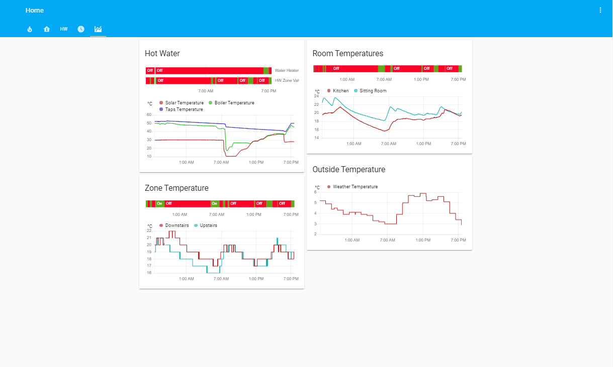

  - badges: []
    cards:
      - entities:
            name: Solar Temperature
            name: Boiler Temperature
            name: Taps Temperature
          - entity: switch.206012432cf432d22b78
        hours_to_show: 24
        refresh_interval: 0
        title: Hot Water
        type: history-graph
      - entities:
        hours_to_show: 24
        refresh_interval: 0
        title: Zone Temperature
        type: history-graph
      - entities:
          - entity: sensor.temperature_sensor_20_0
          - entity: sensor.temperature_sensor_21_0
          - entity: group.sitting_room
        hours_to_show: 24
        refresh_interval: 0
        title: Room Temperatures
        type: history-graph
      - entities:
          - entity: sensor.weather_temperature
        hours_to_show: 24
        refresh_interval: 0
        title: Outside Temperature
        type: history-graph
    icon: 'mdi:chart-areaspline'
    path: graphs
    title: Graphs
Configuration.yaml is now getting quite big!
#--------------============-Heating Schedule version 2.1-----------------------------------------
#--------------Create Boiler thermostat-------------------------------
#virtual thermostat using sensor value from downstairs thermostat and boiler switch.
climate:
- platform: generic_thermostat
  heater: switch.700574032462ab3b7e49 #Boiler Switch
  target_sensor: sensor.current_temp #Boiler room sensor currently reading downstairs zone thermostat
  min_temp: 10
  max_temp: 24
  ac_mode: false
  # target_temp: 17
  cold_tolerance: 0.3
  hot_tolerance: 0
  min_cycle_duration:
    seconds: 5
  keep_alive:
    minutes: 1
  # initial_hvac_mode: "off"
  # away_temp: 12
  precision: 0.1
#Immersion Thermostat
  name: HW thermostat
  heater: switch.bfd019f305520a0591hgke #Immersion Switch
  target_sensor: sensor.temperature_sensor_31_0 #HW Boiler sensor
  min_temp: 0
  max_temp: 65
  ac_mode: false
  # target_temp: 17
  cold_tolerance: 0.3
  hot_tolerance: 0
  min_cycle_duration:
    seconds: 5
  keep_alive:
    minutes: 1
  # away_temp: 12
  precision: 0.1
  #HW Zone Thermostat
  name: HW zone thermostat
  heater: switch.206012432cf432d22b78
  min_temp: 0
  max_temp: 65
  ac_mode: false
  # target_temp: 17
  cold_tolerance: 0.3
  hot_tolerance: 0
  min_cycle_duration:
    seconds: 5
  keep_alive:
    minutes: 1
  # away_temp: 12
  precision: 0.1
    #Sitting Room Thermostat
  name: Sitting Room thermostat
  heater: group.sitting_room
  target_sensor: sensor.temperature_sensor_21_0 #Sitting Room temp Sensor
  min_temp: 0
  max_temp: 24
  ac_mode: false
  # target_temp: 17
  cold_tolerance: 0.3
  hot_tolerance: 0
  min_cycle_duration:
    seconds: 5
  keep_alive:
    minutes: 1
  # away_temp: 12
  precision: 0.1

I’ve simplified the controls with just heating thermostats and system stats on the first page
I’ve added all hot water controls and scheduling to a single page. (Battery is gone in solar sensor, which is why it has flat lined in the picture :smiley: )
I’ve removed hot water from schedule and just added a single auto on time per day, as this suits the solar system better, I heat water in the morning during the winter, using solar to maintain temp as much as possible during the day, and in the summer months do the opposite with hot water heating only coming on if there hasn’t been enough solar during the day.

This is the heating configuration yaml
#-------------------------Heating Schedule version 3.0-----------------------------------------
climate:
  heater: input_boolean.switch_downstairs #Boiler Switch
  min_temp: 10
  max_temp: 24
  ac_mode: false
  cold_tolerance: 0.8
  hot_tolerance: 0.5
  min_cycle_duration:
    seconds: 5
  keep_alive:
    minutes: 1
  precision: 0.1
#upstairs virtual stat
  heater: input_boolean.switch_upstairs #Boiler Switch
  target_sensor: sensor.upstairs_temp #Boiler room sensor currently reading downstairs zone thermostat
  min_temp: 10
  max_temp: 24
  ac_mode: false
  cold_tolerance: 0.8
  hot_tolerance: 0.5
  min_cycle_duration:
    seconds: 5
  keep_alive:
    minutes: 1
  precision: 0.1
  name: HW thermostat
  heater: switch.immersion #Immersion Switch
  min_temp: 0
  max_temp: 65
  ac_mode: false
  cold_tolerance: 1
  hot_tolerance: 0
  min_cycle_duration:
    seconds: 5
  keep_alive:
    minutes: 1
  precision: 0.1
  #HW Zone Thermostat
  heater: switch.hw_zone_valve
  min_temp: 0
  max_temp: 65
  ac_mode: false
  cold_tolerance: 1
  hot_tolerance: 0
  min_cycle_duration:
    seconds: 5
  keep_alive:
    minutes: 1
  precision: 0.1
  min_temp: 0
  max_temp: 24
  ac_mode: false
  cold_tolerance: 0.3
  hot_tolerance: 0.3
  min_cycle_duration:
    seconds: 5
  keep_alive:
    minutes: 1
  precision: 0.1
binary_sensor:
  - platform: workday
    country: 'IE'
    workdays: [mon, tue, wed, thu, fri, sat]
    excludes: [sun, holiday]
#---------------------------input temperatures--------------------------
input_number:  # input number
#-------------------------Zone Temperatures---------------------------------
  t1_upstairs:
    min: 10
    max: 24
    step: 0.5
    mode: box
    icon: mdi:home-thermometer-outline
  t1_sitting_room:
    name: T1 Sitting Room
    min: 10
    max: 24
    step: 0.5
    mode: box
  t2_upstairs:
    min: 10
    max: 24
    step: 0.5
    mode: box
  t2_sitting_room:
    name: T2 Sitting Room
    min: 10
    max: 24
    step: 0.5
    mode: box
  t3_upstairs:
    min: 10
    max: 24
    step: 0.5
    mode: box
  t3_sitting_room:
    name: T3 Sitting Room
    min: 10
    max: 24
    step: 0.5
    mode: box
  t4_upstairs:
    min: 10
    max: 24
    step: 0.5
    mode: box
  t4_sitting_room:
    name: T4 Sitting Room
    min: 10
    max: 24
    step: 0.5
    mode: box
  t5_upstairs:
    min: 10
    max: 24
    step: 0.5
    mode: box
  t5_sitting_room:
    name: T5 Sitting Room
    min: 10
    max: 24
    step: 0.5
    mode: box
  t6_upstairs:
    min: 10
    max: 24
    step: 0.5
    mode: box
  t6_sitting_room:
    name: T6 Sitting Room
    min: 10
    max: 24
    step: 0.5
    mode: box
  t7_upstairs:
    min: 10
    max: 24
    step: 0.5
    mode: box
  t7_sitting_room:
    name: T7 Sitting Room
    min: 10
    max: 24
    step: 0.5
    mode: box
  t8_upstairs:
    min: 10
    max: 24
    step: 0.5
    mode: box
  t8_sitting_room:
    name: T8 Sitting Room
    min: 10
    max: 24
    step: 0.5
    mode: box
#----------------night temp/ min temp----------------------------------------
  t0_temp:
    min: 10
    max: 24
    step: 0.5
    mode: box
#-----------------Boiler Program Temperatures---------------------------------
  t1_temp:  # temperature preset T1
    min: 10
    max: 25
    step: 0.5
    mode: box
  t2_temp:  # temperature preset T2
    min: 10
    max: 25
    step: 0.5
    mode: box
  t3_temp:  # temperature preset T3
    min: 10
    max: 25
    step: 0.5
    mode: box
  t4_temp:  # temperature preset T4
    min: 10
    max: 25
    step: 0.5
    mode: box
  t5_temp:  # temperature preset T5
    min: 10
    max: 25
    step: 0.5
    mode: box
  t6_temp:  # temperature preset T6
    min: 10
    max: 25
    step: 0.5
    mode: box
  t7_temp:  # temperature preset T7
    min: 10
    max: 25
    step: 0.5
    mode: box
  t8_temp:  # temperature preset T8
    min: 10
    max: 25
    step: 0.5
    mode: box
#---------------------immersion heater--------------------------------
  immersion_temp:
    min: 30
    max: 65
    step: 0.5
    mode: box
    icon: mdi:hot-tub
  immersion_timer:  # set time for immersion heater
    min: 10
    max: 120
    step: 1
    mode: box
    icon: mdi:timer-sand
#-----------------boolean switches-------------
input_boolean:
  heating_master: # if ON enable heating week timer
    name: Heating Auto timer
    icon: mdi:av-timer
  switch_immersion_timer:

Hot Water Automation yaml
#--------------------------------Hot Water from Boiler and Immersion------------------
#------------------------------------ Immersion Boost Timer----------------------------
- id: 'immersion boost 1'
  alias: Immersion Timer
  description: Immersion Boost on for preset time
  trigger:
  - entity_id: input_boolean.switch_immersion_timer
    platform: state
    to: 'on'
  condition: []
  action:
  - service: climate.set_hvac_mode
    entity_id: climate.hw_thermostat
    data_template:
      hvac_mode: heat
  - service: climate.set_temperature
    data_template:
      temperature: '{{ states.input_number.immersion_temp.state }}'
- id: 'immersion boost 2'
  alias: Immersion timed off
  description: Immersion Boost off after preset time
  trigger:
  - platform: state
    to: 'off'
  - platform: state
    to: 'on'
    for:
      minutes: '{{ states.input_number.immersion_timer.state | int }}'
  action:
  - service: input_boolean.turn_off
      hvac_mode: 'off'
#---------------------------Boiler Hot Water Boost Timer --------------------------
- id: 'hot water boost 1'
  alias: HW Boiler Timer
  description: HW Boiler Boost on for preset time
  trigger:
  - entity_id: input_boolean.switch_hw_timer
    platform: state
    to: 'on'
  condition: []
  action:
    entity_id: climate.hw_zone_thermostat
    data_template:
      hvac_mode: heat
    data_template:
- id: 'hot water boost 2'
  alias: HW Boiler timed off after preset time
  description: HW Boiler Boost off
  trigger:
  - platform: state
    to: 'off'
  - platform: state
    to: 'on'
    for:
  action:
      hvac_mode: 'off'
#----------------Imersion automatic on time, calls boost automation at selected time----------------
- id: 'immersion on'
  alias: Immersion On Time
  description: Immersion Automatic On Time
  trigger:
  - platform: template
    value_template: '{{ states.sensor.time.state == states.input_datetime.immersion_auto_on.state[0:5]
  condition: []
  action:
    service: input_boolean.turn_on
#------------Boiler Hot Water automatic on time, calls boost automation at selected time-----------------
- id: 'hot water on'
  alias: HW On Time
  description: HW Automatic On Time
  trigger:
    value_template: '{{ states.sensor.time.state == states.input_datetime.hw_auto_on.state[0:5]
  condition: []
  action:
  mode: single
#--------Work in progress, skip immersion Auto on, if forecast for clear skys, optimise solar water heating-------
- id: 'weather based immersion'
  alias: Smart Weather Based Immersion On
  description: ''
  trigger:
  - platform: time
    at: 00:10:00
  condition: []
  action:
  - service_template: "{% if states('sensor.cloud_forecast_average') | float < 20\
      \ %}\n  homeassistant.turn_off\n{% else %}\n  homeassistant.turn_on\n{% endif\
      \ %}\n"
    entity_id: automation.immersion_on_time
  mode: single
Automation and Config yaml files have also been broken down into smaller easier to read files.
