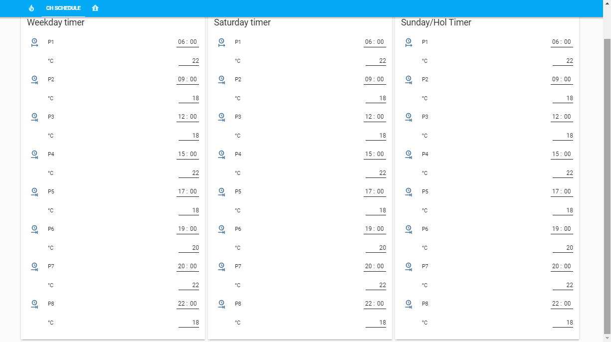

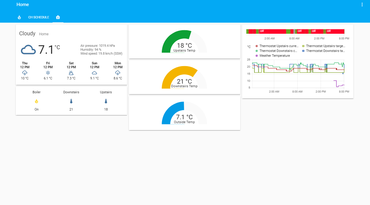

Multi-zone Heating with scheduling
Set up my first home automation using Home assistant using mostly code borrowed from this forum. Really need to thank @gt4020 Giovanni for the code to set up schedule’s. Currently have 2 heating zones working and boiler control. Plan on adding hot water as an extra zone from boiler but also solar water and electric immersion heater, need to acquire more sensors and switches.
Current features:
3 weekly times schedules with 8 segments per day + night temp = 9
Boost timer with temperature and time selection.
Zone temperature settings.
Zone valve protection, de-energize when heat is off.
Planned features:
Separate hot water Zone
Solar hot water monitoring
Immersion heater control
Humidity sensors in bathrooms with fan control

#--------------Create Boiler thermostat-------------------------------
#virtual thermostat using sensor value from downstairs thermostat and boiler switch.
climate:
  heater: switch.700574032462ab3b7e49 #Boiler Switch
  target_sensor: sensor.current_temp #Boiler room sensor currently reading downstairs zone thermostat
  min_temp: 10
  max_temp: 24
  ac_mode: false
  # target_temp: 17
  cold_tolerance: 0.3
  hot_tolerance: 0
  min_cycle_duration:
    seconds: 5
  keep_alive:
    minutes: 1
  # initial_hvac_mode: "off"
  # away_temp: 12
  precision: 0.1

#---------------------------input temperatures--------------------------
input_number:  # input number
#night temps
  t0_temp:
    min: 10
    max: 20
    step: 0.5
    mode: box
    icon: mdi:home-thermometer
#weekday temps
  t1_work:  # temperature preset T1
    min: 10
    max: 25
    step: 0.5
    mode: box
    icon: mdi:blank
  t2_work:  # temperature preset T2
    min: 10

  - badges:
      - entity: sun.sun
      - entity: sensor.weather_temperature
      - cards:
          - entity: climate.ha_thermo
            type: thermostat
          - entities:
              - entity: input_boolean.switch_boiler_timer
              - entity: input_number.boiler_timer
                name: Minutes 1 - 120
              - entity: input_number.temp_boost
                name: Boost Temperature °C
              - entity: input_boolean.heating_master
                name: Heating Schedule On/Off
            type: entities
        type: vertical-stack
      - cards:
          - entity: sensor.upstairs_temp
            max: 30
            min: 0
            severity:
              green: 18
              red: 23
              yellow: 20
            theme: default
            type: gauge
            unit: °C
          - entity: sensor.current_temp
            max: 30
            min: 0
            severity:
              green: 18
              red: 23
              yellow: 20
            theme: default
            type: gauge
            unit: °C
          - entities:
              - entity: input_number.temp_up
                name: Max Upstairs Temperature °C
              - entity: input_number.temp_down
                name: Max Downstairs Temperature °C
              - entity: input_number.t0_temp
                name: Min Night Temperature °C
            show_header_toggle: false
            type: entities
    icon: 'mdi:fire'
    path: default_view
    title: Central Heating

          - entity: input_datetime.p1_weekday_on
          - entity: input_number.t1_work
          - entity: input_datetime.p2_weekday_on
          - entity: input_number.t2_work
          - entity: input_datetime.p3_weekday_on
          - entity: input_number.t3_work
          - entity: input_datetime.p4_weekday_on
          - entity: input_number.t4_work
          - entity: input_datetime.p5_weekday_on
          - entity: input_number.t5_work
          - entity: input_datetime.p6_weekday_on
          - entity: input_number.t6_work
          - entity: input_datetime.p7_weekday_on
          - entity: input_number.t7_work
          - entity: input_datetime.p8_weekday_on
          - entity: input_number.t8_work
        title: Weekday timer
        type: entities
      - entities:
          - entity: input_datetime.p1_saturday_on
          - entity: input_number.t1_sat
          - entity: input_datetime.p2_saturday_on
          - entity: input_number.t2_sat
          - entity: input_datetime.p3_saturday_on
          - entity: input_number.t3_sat
          - entity: input_datetime.p4_saturday_on
          - entity: input_number.t4_sat
          - entity: input_datetime.p5_saturday_on
          - entity: input_number.t5_sat
          - entity: input_datetime.p6_saturday_on
          - entity: input_number.t6_sat
          - entity: input_datetime.p7_saturday_on
          - entity: input_number.t7_sat
          - entity: input_datetime.p8_saturday_on
          - entity: input_number.t8_sat
        title: Saturday timer
        type: entities
      - entities:
          - entity: input_datetime.p1_holiday_on
          - entity: input_number.t1_sun
          - entity: input_datetime.p2_holiday_on
          - entity: input_number.t2_sun
          - entity: input_datetime.p3_holiday_on
          - entity: input_number.t3_sun
          - entity: input_datetime.p4_holiday_on
          - entity: input_number.t4_sun
          - entity: input_datetime.p5_holiday_on
          - entity: input_number.t5_sun
          - entity: input_datetime.p6_holiday_on
          - entity: input_number.t6_sun
          - entity: input_datetime.p7_holiday_on
          - entity: input_number.t7_sun
          - entity: input_datetime.p8_holiday_on
          - entity: input_number.t8_sun
        title: Sunday/Hol Timer
        type: entities

  - badges: []
      - entity: weather.home
        type: weather-forecast
      - entities:
          - entity: switch.700574032462ab3b7e49
            icon: 'mdi:fire'
            icon: 'mdi:thermometer'
        show_name: true
        show_state: true
        type: glance
      - cards:
            max: 30
            min: 0
            severity:
              green: 18
              red: 23
              yellow: 20
            theme: default
            type: gauge
            unit: °C
            max: 30
            min: 0
            severity:
              green: 18
              red: 23
              yellow: 20
            theme: default
            type: gauge
            unit: °C
        max: 35
        min: -20
        severity:
          green: 14
          red: 22
          yellow: 18
        theme: default
        type: gauge
      - entities:
          - entity: climate.bf0dca95cb90411960fl8n
          - entity: climate.bfb4fbcb25305e7371a3yn
        hours_to_show: 24
        refresh_interval: 0
        type: history-graph
    icon: 'mdi:home-thermometer'
    panel: false
    path: zones
    title: Temp Sensors

Is there a point where the target_sensor: on the generic_thermostat is switched to/from upstairs_temp: or am I miss understanding on how your zones are used and affected by the schedule?
I have a single heat source, but would like to schedule to uses downstairs temp sensors during the day and upstairs temp sensors during the night. Currently it’s just based on a ‘whole house average’ using min_max, type: mean on a Generic_thermostat.
I thought I was going to need two generic thermostats, but this looks like you’re only using one?
Hi Kob,
No you are not missing anything and this is very much a work in progress, first phase was to emulate how my heating system worked previously so at least others in the house were not cold and upset. So old system used mechanical timer on boiler and mechical thermostats on valves meaning boiler was often just dry cycling. The first improvment on my old system was thermostat control of Boiler.
Downstairs zone thermostat currently controls downstairs zone valve and upstairs controls upstairs zone valve. The scheduale sets the temperature at which the boiler starts/stops, the zone valves have mearly max temp values. I’ve also set zone valves to close everytime the boiler shutsdown as I recently had to replace all motor heads as valves were constantly under power when heating is off.
The generic thermostat reads the downstairs thermostat as a sensor and it controls the boiler. As we like the upstairs a few degrees cooler than downstairs physics looks after the rest, heat rises and upstairs has a lower set point so it heats quicker and turns off long befor downstairs reaches temperature. We don’t heat the house at night as upstairs stays warm long enough and house is well insulated, but the heating will come on if temp falls below the set night time value if it is very cold. (hasn’t happened yet and its about -4 outside the last few nights). Don’t know how well this would work for you as it will depend on your climate and level of insulation.
I’m sure you could call heating based on any number of temp sensors using some logic with “or” statements. Like I said its very much work in progress, at the moment the house remains a comfortable temperature all day with the boiler cycling less than it did on old system, as a consequence my hot water is now warm water so I will be adding new sensors for water tank this week and providing some new code to ensure enough hot water is available.
Added sensors to Hot Water tank, and setup an Immersion Heater Boost program to top up Hot water if not enough is produced by Central Heating or Solar panels by a set time in the evening.
#night temps
  t0_temp:
    min: 10
    max: 20
    step: 0.5
    initial: 16
    mode: box
#weekday temps
    min: 10
    max: 25
    step: 0.5
    initial: 22
    mode: box
    icon: mdi:blank
    min: 10
    max: 25
    step: 0.5
    initial: 18
    mode: box
    icon: mdi:blank
  t3_work:  # temperature preset T3
    min: 10
    max: 25
    step: 0.5
    initial: 20
    mode: box
    icon: mdi:blank
  t4_work:  # temperature preset T4
    min: 10
    max: 25
    step: 0.5
    initial: 22
    mode: box
    icon: mdi:blank
  t5_work:  # temperature preset T5
    min: 10
    max: 25
    step: 0.5
    initial: 20
    mode: box
    icon: mdi:blank
  t6_work:  # temperature preset T6
    min: 10
    max: 25
    step: 0.5
    initial: 22
    mode: box
    icon: mdi:blank
  t7_work:  # temperature preset T7
    min: 10
    max: 25
    step: 0.5
    initial: 22
    mode: box
    icon: mdi:blank
  t8_work:  # temperature preset T8
    min: 10
    max: 25
    step: 0.5
    initial: 18
    mode: box
    icon: mdi:blank
#sat temps
  t1_sat:  # temperature preset T1
    min: 10
    max: 25
    step: 0.5
    initial: 22
    mode: box
    icon: mdi:blank
  t2_sat:  # temperature preset T2
    min: 10
    max: 25
    step: 0.5
    initial: 18
    mode: box
    icon: mdi:blank
  t3_sat:  # temperature preset T3
    min: 10
    max: 25
    step: 0.5
    initial: 20
    mode: box
    icon: mdi:blank
  t4_sat:  # temperature preset T4
    min: 10
    max: 25
    step: 0.5
    initial: 22
    mode: box
    icon: mdi:blank
  t5_sat:  # temperature preset T5
    min: 10
    max: 25
    step: 0.5
    initial: 20
    mode: box
    icon: mdi:blank
  t6_sat:  # temperature preset T6
    min: 10
    max: 25
    step: 0.5
    initial: 22
    mode: box
    icon: mdi:blank
  t7_sat:  # temperature preset T7
    min: 10
    max: 25
    step: 0.5
    initial: 22
    mode: box
    icon: mdi:blank
  t8_sat:  # temperature preset T8
    min: 10
    max: 25
    step: 0.5
    initial: 18
    mode: box
    icon: mdi:blank
#Sunday/Holiday temps
  t1_sun:  # temperature preset T1
    min: 10
    max: 25
    step: 0.5
    initial: 22
    mode: box
    icon: mdi:blank
  t2_sun:  # temperature preset T2
    min: 10
    max: 25
    step: 0.5
    initial: 18
    mode: box
    icon: mdi:blank
  t3_sun:  # temperature preset T3
    min: 10
    max: 25
    step: 0.5
    initial: 20
    mode: box
    icon: mdi:blank
  t4_sun:  # temperature preset T4
    min: 10
    max: 25
    step: 0.5
    initial: 22
    mode: box
    icon: mdi:blank
  t5_sun:  # temperature preset T5
    min: 10
    max: 25
    step: 0.5
    initial: 20
    mode: box
    icon: mdi:blank
  t6_sun:  # temperature preset T6
    min: 10
    max: 25
    step: 0.5
    initial: 22
    mode: box
    icon: mdi:blank
  t7_sun:  # temperature preset T7
    min: 10
    max: 25
    step: 0.5
    initial: 22
    mode: box
    icon: mdi:blank
  t8_sun:  # temperature preset T8
    min: 10
    max: 25
    step: 0.5
    initial: 18
    mode: box
    icon: mdi:blank
#immersion heater
  immersion_temp:
    min: 30
    max: 65
    step: 0.5
    initial: 50
    mode: box
    icon: mdi:hot-tub
  immersion_timer:  # set time for immersion heater
    initial: 60
    min: 10
    max: 120
    step: 1
    mode: box
    icon: mdi:timer-sand
#zone temperature inputs
  temp_up:  # temperature preset Upstairs
    name: Temp Upstairs Timer
    min: 10
    max: 25
    step: 0.5
    initial: 20
    mode: box
    icon: mdi:home-thermometer-outline
  temp_down:  # temperature preset Downstairs
    name: Temp Downstairs Timer
    min: 10
    max: 25
    step: 0.5
    initial: 22
    mode: box
#Boost timer settings
  boiler_timer:  # set time for boost heating start
    initial: 60
    min: 10
    max: 120
    step: 1
    mode: box
  temp_boost:  # temperature preset boost
    min: 10
    max: 25
    step: 0.5
    initial: 22
    mode: box

input_datetime:
  p1_weekday_on:
    has_time: true
    initial: '06:00:00'
    icon: mdi:clock-start
  p2_weekday_on:
    has_time: true
    initial: '09:00:00'
    icon: mdi:clock-end
  p3_weekday_on:
    has_time: true
    initial: '13:00:00'
    icon: mdi:clock-end
  p4_weekday_on:
    has_time: true
    initial: '15:00:00'
    icon: mdi:clock-end
  p5_weekday_on:
    has_time: true
    initial: '17:00:00'
    icon: mdi:clock-end
  p6_weekday_on:
    has_time: true
    initial: '19:00:00'
    icon: mdi:clock-end
  p7_weekday_on:
    has_time: true
    initial: '20:00:00'
    icon: mdi:clock-end
  p8_weekday_on:
    has_time: true
    initial: '22:00:00'
    icon: mdi:clock-end
  p1_saturday_on:
    has_time: true
    initial: '06:00:00'
  p2_saturday_on:
    has_time: true
    initial: '09:00:00'
    icon: mdi:clock-end
  p3_saturday_on:
    has_time: true
    initial: '13:00:00'
    icon: mdi:clock-end
  p4_saturday_on:
    has_time: true
    initial: '15:00:00'
    icon: mdi:clock-end
  p5_saturday_on:
    has_time: true
    initial: '17:00:00'
    icon: mdi:clock-end
  p6_saturday_on:
    has_time: true
    initial: '19:00:00'
    icon: mdi:clock-end
  p7_saturday_on:
    has_time: true
    initial: '20:00:00'
    icon: mdi:clock-end
  p8_saturday_on:
    has_time: true
    initial: '22:00:00'
    icon: mdi:clock-end
  p1_holiday_on:
    has_time: true
    initial: '06:00:00'
  p2_holiday_on:
    has_time: true
    initial: '09:00:00'
    icon: mdi:clock-end
  p3_holiday_on:
    has_time: true
    initial: '13:00:00'
    icon: mdi:clock-end
  p4_holiday_on:
    has_time: true
    initial: '15:00:00'
    icon: mdi:clock-end
  p5_holiday_on:
    has_time: true
    initial: '17:00:00'
    icon: mdi:clock-end
  p6_holiday_on:
    has_time: true
    initial: '19:00:00'
    icon: mdi:clock-end
  p7_holiday_on:
    has_time: true
    initial: '20:00:00'
    icon: mdi:clock-end
  p8_holiday_on:
    has_time: true
    initial: '22:00:00'
    icon: mdi:clock-end
  immersion_auto_on:
    name: Imerrsion Auto On
    has_time: true
    initial: '19:00:00'
    icon: mdi:clock-end

      - cards:
            type: thermostat
          - entities:
                name: Boost Central Heating
                name: Minutes 10 - 120
            type: entities
      - cards:
            max: 30
            min: 0
            severity:
              green: 18
              red: 23
              yellow: 20
            theme: default
            type: gauge
            unit: °C
            max: 30
            min: 0
            severity:
              green: 18
              red: 23
              yellow: 20
            theme: default
            type: gauge
            unit: °C
          - entities:
            type: entities
    icon: 'mdi:fire'
    path: default_view
        type: entities
      - entities:
        type: entities
      - entities:
        type: entities
    icon: 'mdi:clock'
    path: misc
    title: CH Schedule
  - badges: []
        max: 35
        min: -20
        severity:
          green: 14
          red: 22
          yellow: 18
        theme: default
        type: gauge
      - cards:
            max: 30
            min: 0
            severity:
              green: 18
              red: 23
              yellow: 20
            theme: default
            type: gauge
            unit: °C
            max: 30
            min: 0
            name: Front Room Temp
            severity:
              green: 18
              red: 23
              yellow: 20
            theme: default
            type: gauge
            unit: °C
          - entity: sensor.temperature_sensor_20_0
            max: 30
            min: 0
            severity:
              green: 18
              red: 23
              yellow: 20
            theme: default
            type: gauge
          - entity: sensor.temperature_sensor_21_0
            max: 30
            min: 0
            name: Back Room Temp
            severity:
              green: 18
              red: 23
              yellow: 20
            theme: default
            type: gauge
        title: Room Temperature
      - Name: Water Temp Sensors
          - entity: sensor.temperature_sensor_32_0
            max: 100
            min: 0
            name: HW Taps Temp
            severity:
              green: 35
              red: 55
              yellow: 45
            theme: default
            type: gauge
          - entity: sensor.temperature_sensor_31_0
            max: 100
            min: 0
            name: HW Boiler Temp
            severity:
              green: 35
              red: 55
              yellow: 45
            theme: default
            type: gauge
          - entity: sensor.temperature_sensor_30_0
            max: 100
            min: 0
            name: HW Solar Temp
            severity:
              green: 35
              red: 55
              yellow: 45
            theme: default
            type: gauge
        title: Hot Water Temperature
      - entities:
            icon: 'mdi:fire'
            icon: 'mdi:home-thermometer-outline'
          - entity: switch.bfd019f305520a0591hgke
            icon: 'mdi:hot-tub'
        show_name: true
        show_state: true
        type: glance
      - entities:
        hours_to_show: 24
        refresh_interval: 0
        type: history-graph
    panel: false
    path: zones
    title: Temp Sensors
I’ve Completely redesigned the Scheduling Section
It now includes scheduling for each individual zone.

  immersion_auto_on:
    has_time: true
    initial: '19:00:00'
    icon: mdi:clock-end
Lovelace
title: Home
views:
  - badges:
      - entity: sun.sun
      - entity: sensor.time

      - cards:
            max: 30
            min: 0
            severity:
              green: 18
              red: 23
              yellow: 20
            theme: default
            type: gauge
            unit: °C
            max: 30
            min: 0
            severity:
              green: 18
              red: 23
              yellow: 20
            theme: default
            type: gauge
            unit: °C
          - entities:
            type: entities
          - entities:
                icon: 'mdi:fire'
                icon: 'mdi:hot-tub'
            show_name: true
            show_state: true
            type: glance
    icon: 'mdi:fire'
    path: default_view

      - cards:
          - entities:
              - entity: input_boolean.switch_weekday_p1
              - entity: input_boolean.switch_saturday_p1
              - entity: input_boolean.switch_sunday_p1
            show_icon: false
            show_name: true
            show_state: true
            type: glance
          - entities:
              - entity: input_datetime.p1_on
                icon: 'mdi:clock-start'
              - entity: input_number.t1_upstairs
              - entity: input_number.t1_temp
              - entity: input_number.t1_sitting_room
                name: Sitting Room Temp
              - entity: input_number.t1_hot_water
                name: Hot Water Temp
              - entity: input_datetime.p2_on
            type: entities
        title: Heating Schedule 1
