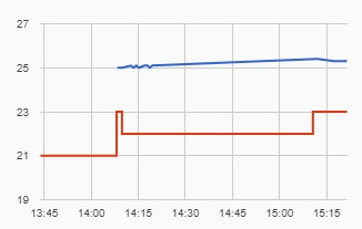

I’m using HA for quite a while now and I’ve set up almost everything to my needs, but there’s one thing I miss greatly: The ability to show multiple temperatures in one graph, like below:
(Image from Google)
I know that HA can do it, but I’m not sure about multiple sensors in one.
