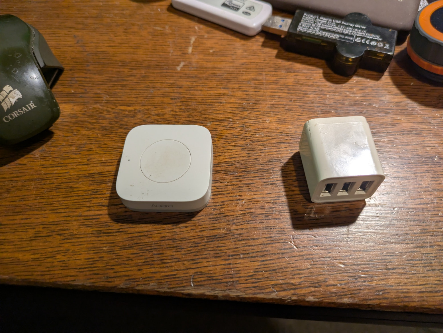

These are the two devices - an Aoara on the left and something else on the right - I did see the right hand one posted somewhere else saying did anyone get this working

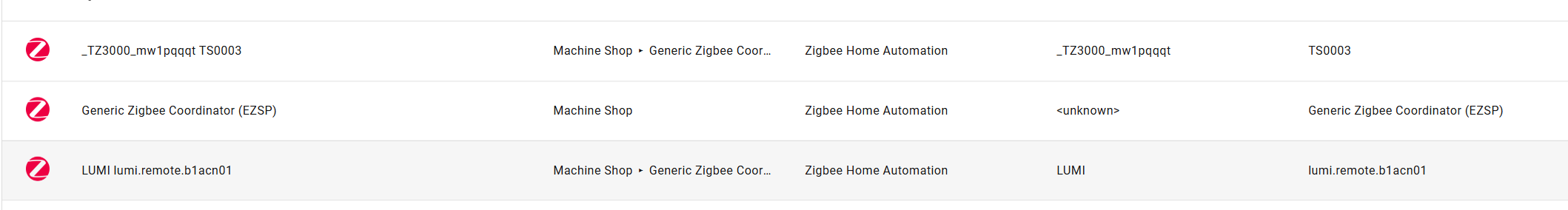

This is what z2m showed me (I’m a bit pendatic about backups - so I restored this to get this so these are actually not connected over zigbee anymore )

The triple usb switch has also been supported since at least a year & a half. I know because I own that exact model.
Something went wrong when you were trying to pair the devices & they weren’t recognised correctly. I’m suspecting interference issues since that’s the most obvious one.
PS - your AI is wrong. Both ZHA & Z2M behave the same way in supporting devices. Their only difference is the codebase & database, but a quirk & converter are essentially the same thing.
