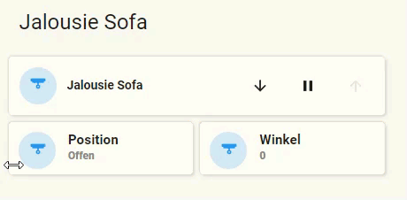

It would be great if there is something like this:
16-04-2022_19-38-18
I created this with a card mod, but i have a problem with the css. There is a gap:
