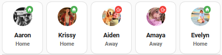

Hello masters of mushroom dashboards. I am using a presence solution with nodered that provides more granularity of a persons status. Doing so requires the use of a sensor template. My goal is to replicate the cool little icons displayed above the entity image in the mushroom_persons card in the mushroom_entity card. Any way to make image1 below look like image2?
You should be able to use something similar to:
badge_icon: >-
     {% if state_attr('device_tracker.person', 'place') == "Home" %} mdi:home {% else %} mdi:home-off {% endif %}
I figured it out…in case anyone is interested:
    entity: sensor.your-sensor
    picture: '{{state_attr(entity,''entity_picture'')}}'
    primary: '{{state_attr(entity,''friendly_name'')}}'
    secondary: '{{states(entity)}}'
    badge_icon: >-
      {% if states(entity)=="Home" %} mdi:home {% elif states(entity)=="Arrived"
      %} mdi:home {% elif states(entity)=="Just Leave" %} mdi:home-off {% elif
      states(entity)=="Away" %} mdi:home-off {% endif %}
    badge_color: >-
      {% if states(entity)=="Home" %} green {% elif states(entity)=="Arrived" %}
      yellow {% elif states(entity)=="Just Leave" %} orange {% elif
      states(entity)=="Away" %} red {% endif %}
    layout: vertical
    tap_action:
      action: none
    hold_action:
      action: none
    double_tap_action:
      action: none
    fill_container: true
    icon: ''
