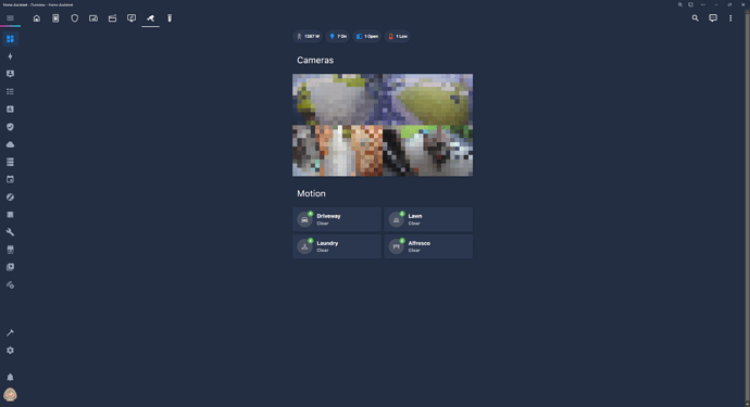

I wanted to share my dashboards that was inspired by you all (special thanks to @piitaya and @rhysb). If you need my code, feel free to reach out.
NB: Open images in new tab
Home:
Switches:
Sensors:
Devices:
Media:
Computers:
Cameras:
EDIT: Updated screenshots

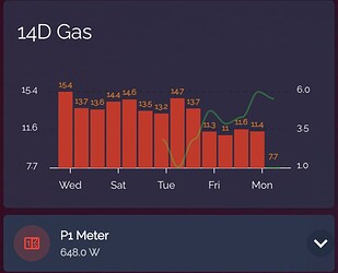

Finally making some progress with the fold entities & auto-entities now 2 layout questions:
@rhysb (or others) Any way to get the fold entity chevron within the card outline (red below) instead of outside the darker background? [SOLVED]
Is there a way to have the expand of the auto entity to go underneath both horizontal stacked cards instead of only under the first card? Again red space in picture below.

Thanks! This works. Guess its the stack in stack element.
@codedmind update. If you look at picture below you can see that the modified card is slightly lighter grey (where the chevron sits vs the rest of the left card & compared to the right card. Do you know what part of you code is potentially causing this? Not super easy to see, but it is there
This shows it better (top card vs bottom card). My cards have a slight opacity, could it be your card mod ‘overrides’ that?
It’s still very much a work in progress. When I have time I’ll probably make it into a custom tab card.
