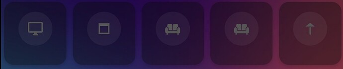

@piitaya Hi Paul, I read trough all posts and you already received many congrats. But let me add one more. Magnificent set of cards !
However I am also looking for some more flexibility regarding icon en icon color control, based on the state of an entity. This is already included in the template card, but I also could use this functionality on specific designed cards like the cover card. Is there any chance that this functionality will also be made available on some of the more specific cards like the cover card?
I do understand you do not want to overcomplicate things but this would be a really nice addition.
My current workaround is to “mimic” the cover card using 2 nested grid cards filled with 4 template cards. Below in the picture on top the out-of-the-box mushroom variant and below my current workaround.
