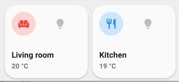

With mush-:
CleanShot 2023-02-03 at 09.24.56@2x
Removing mush- behaves correctly, although I’d probably add more spacing between the inset chips:
CleanShot 2023-02-03 at 09.26.38@2x
