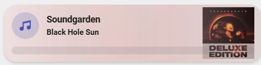

Turns out its Firefox not getting the styling right. happened to look on Edge and it looks the same now. So i had a look to see if i can find a solution and i think i found one.
you should just be able to change the background-position: right; to background-position: 96%; in the stack in card (that contains all other cards) it will then be nudged ever so slightly to the left allowing to show all 4 corners
oh and if you wanted to swap only artist and track whilst music is playing you can do this instead (i admit it is a bit weird for it to say Idle and then Office Speaker for example underneath swapping the default way):
