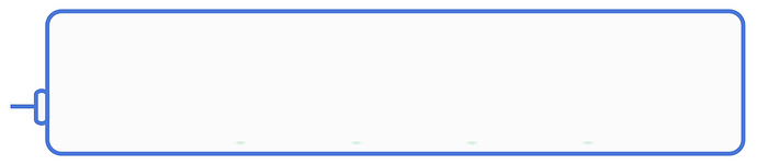

thats my socket :grinning:
Ekran görüntüsü 2024-02-17 005203
type: custom:stack-in-card
cards:
    card_mod:
      style: |
        ha-card {
          --ha-card-background: none;
          height: 99px !important;
          background: url('/local/images/icon/merossbg.png') center / cover no-repeat !important;
          --ha-card-border-radius: 1px;
          margin-left: -2px !important;
          transition: all 0s;
          padding: 0px !important;
