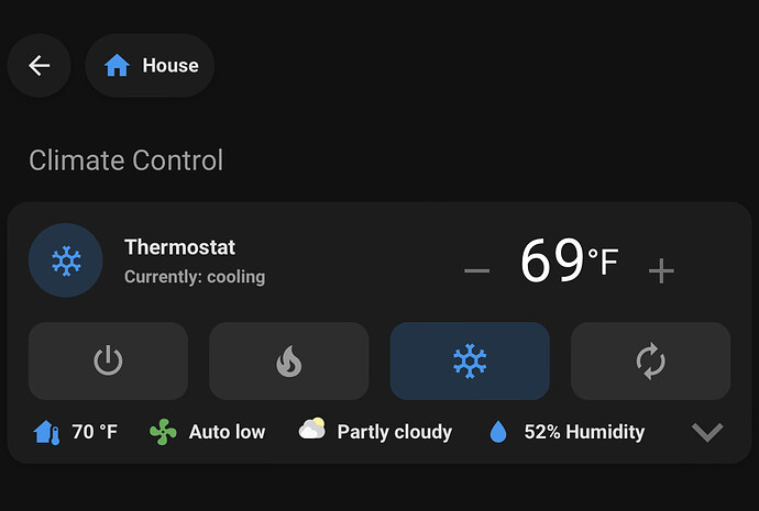

I liked how rhysb’s thermostat dropped down so I updated mine to have a dropdown menu to save space. Here’s the pics and code if you guys want it.
type: custom:stack-in-card
keep:
  margin: false
  box_shadow: false
  background: false
cards:
  - type: grid
    square: false
    columns: 2
    cards:
        style: |
          ha-card {
            padding-bottom: 14px !important;
        primary: Thermostat
        secondary: |
          Currently: {{ state_attr('climate.thermostat', 'hvac_action') }}
        icon: |-
          {% set mode = states('climate.thermostat') %}
          {% if mode == 'off' %}
          mdi:power
          {% elif mode == 'cool' %}
          mdi:snowflake
          {% elif mode == 'heat' %}
          mdi:fire
          {% elif mode == 'heat_cool' %}
          mdi:autorenew
          {% else %}
          mdi:home-thermometer
          {% endif %}
        icon_color: |-
          {% set status = state_attr('climate.thermostat','hvac_action') %}
          {% if status == 'off' %}
          grey
          {% elif status == 'cooling' %}
          blue
          {% elif status == 'heating' %}
          red
          {% else %}
          grey
          {% endif %}
        tap_action: none
      - type: vertical-stack
        cards:
          - type: custom:simple-thermostat
            style: |
              ha-card {
                --st-spacing: 0px;
              ha-card .current--value {
                color: #ffffff;
              header {
                margin-bottom: 10px !important;
                padding-bottom: 0px !important;
              ha-card .thermostat-trigger {
                color: #6f6f6f;
            entity: climate.thermostat
            header:
              icon: false
            decimals: '0'
            fallback: 'Off'
            hide:
              temperature: true
              state: true
            layout:
              mode:
                names: false
                icons: false
                headings: false
              step: row
            step_size: '1'
            control:
              hvac:
                'off': false
                heat: false
                cool: false
                heat_cool: false
    style: |
      ha-card {
        --st-font-size-toggle-label: 6px
        --st-spacing: 0px;
        --st-default-spacing: 0px;
        --st-mode-background: #2d2d2d;
        margin-left: 12px;
        margin-right: 12px;
      ha-card .mode-item.active.off {
        background: #363636;
        color: #9e9e9e;
      ha-card .mode-item.active.cool {
        background: #1d3447;
        color: #2196f3;
      ha-card .mode-item.active.heat {
        background: #472421;
        color: #f44336;
      ha-card .mode-item.active.heat_cool {
        background: #493516;
        color: #ff9800;
      ha-card .mode-item.active {
        background: #263926;
        color: #4caf50;
      ha-card .mode-item.active:hover {
        color: #9e9e9e;
      ha-card .mode-item:hover {
        color: #9e9e9e;
      ha-card .mode-item {
        --st-spacing: 10px;
        border-radius: 10px;
      ha-card .modes {
        grid-gap: 12px
    header: false
    setpoints: false
    hide:
      temperature: true
      state: true
    layout:
      mode:
        headings: false
        icons: true
        names: false
      step: row
    control:
      hvac:
        'off':
        heat:
        cool:
        heat_cool:
  - type: custom:mushroom-chips-card
    style: |
      ha-card {
        --chip-box-shadow: none;
        --chip-background: none;
        --chip-spacing: 0px;
        --chip-padding: 0 0.2em
    alignment: justify
    chips:
      - type: template
        content: '{{state_attr(entity, ''current_temperature'')}} °F'
        icon: mdi:home-thermometer
        tap_action:
          action: more-info
        icon_color: |-
          {% set state=states(entity) %}
          {% if state=='cool' %}
          blue
          {% elif state=='heat' %}
          red
          {% else %}
          grey
          {% endif %}
        style: |
          ha-card {
            margin-left: 6px;
      - type: template
        content: |
          {{ state_attr(entity, 'fan_mode') }}
        icon: mdi:fan
        icon_color: green
        tap_action: none
      - type: weather
        entity: weather.karr_daynight
        show_conditions: true
        show_temperature: false
      - type: template
        double_tap_action:
          action: none
        content: '{{ states(entity) }}% Humidity'
        entity: sensor.karr_relative_humidity
        icon: mdi:water
        icon_color: blue
        tap_action:
          action: none
        hold_action:
          action: none
      - type: template
        icon: |-
          {% if is_state(entity, 'off') %}
            mdi:chevron-down
          {% elif is_state(entity, 'on') %}
            mdi:chevron-up
          {% endif %}
        tap_action:
          action: toggle
        entity: input_boolean.thermostat_dropdown
        icon_color: disabled
        style: |
          ha-card {
            --chip-icon-size: 1em
  - type: conditional
    conditions:
      - entity: input_boolean.thermostat_dropdown
        state: 'on'
    card:
      keep:
        margin: false
        box_shadow: false
        background: false
      cards:
        - type: grid
          square: false
          columns: 3
          cards:
            - type: custom:mushroom-entity-card
              entity: sensor.thermostat_air_temperature
              primary_info: state
              secondary_info: name
              icon_color: green
              entity: sensor.karr_temperature
              primary_info: state
              icon_color: blue
              style: |
                ha-card {
                  --st-spacing: 0px;
                  --st-default-spacing: 1.6px;
                  margin-right: 12px;
                  color: #4caf50;
                  color: #9e9e9e;
                  color: #9e9e9e;
                  --st-spacing: 6px;
                ha-card .modes {
                  grid-gap: 12px
              header: false
              setpoints: false
              hide:
                temperature: true
                state: true
              layout:
                mode:
                  headings: false
                  icons: true
                  names: false
                step: row
              control:
                hvac:
                  'off': false
                  heat: false
                  cool: false
                  heat_cool: false
                fan:
                  Auto low:
                    icon: mdi:fan-auto
                  Low:
                    icon: mdi:fan
        - type: custom:mini-graph-card
          entities:
            - entity: sensor.thermostat_air_temperature
              name: Inside Temperature
              color: '#4caf50'
            - entity: sensor.karr_temperature
              name: Outside Temperature
              color: '#2196f3'
              y_axis: secondary
          hours_to_show: 24
          line_width: 3
          font_size: 50
          animate: true
          show:
            icon: false
            state: false
            legend: false
            fill: fade
