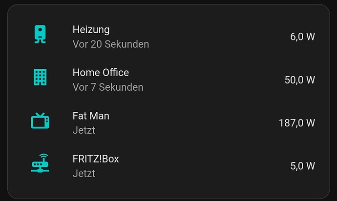

I would like to have a list that only shows me the devices that are currently using electricity, like this:
In addition, the consumption values ​​should be displayed in different colors depending on the consumption. From value x - y in green, from value m - n in orange and from a - b in red. No idea which card can be used to implement this.

yes, with auto entitles, include entities that are using above 1w
here’s a start for Auto Entities.
read through the link above and fine tune what you want to display.
