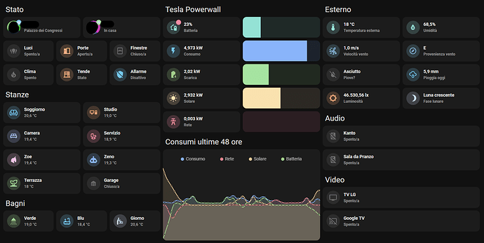

New tablet home page:
no card-mod, just mushroom, mini-graph-card and bar-card
using layout-card to define the columns. (this is the screenshot from the desktop, on the tablet the bottom is aligned)
I have used peaces from my mobile dashboard, from the home page and some other from details pages.
every link like the rooms (stanze) and the category pages (status, lights, doors, etc…) brings you to the same rooms as the mobile home page.
So I have 2 home pages, one for smartphone and this for the tablet, while all the other subpages are the same.
For reference, this is the mobile home page:
I like that a lot, well done! Nice and subtle, and well laid out.
May ask if you can share the code for your whole card? I like it and would like to implement on my setup.
You have the full card at the end of this file in my Github.

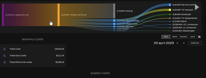

Thought I’d share some of my Dash, making use of all HA Tools. The whole concept is from a guy who posted in a forum. He uses a variety of tools in a very smart way. Credits go to him and I tailered it a bit to my likings. Not fully Mushroom but maybe good enough for inspiration. Some tools used:
Fully kioskbrowser & Browsermod, getting rid of the default nav bar. Looking glas, opens a full screen pop-up searching for entities. Holding the looking glas icon, disables Kioskmode and provides a means to edit the gui. The top right card with " sensors" opens a pop-up with available options.
By means of browsermod is serves different layouts available for mobile and for desktop. On desktop the left room cards control the right (conditional part) showing the relevant room on the right. The actual pages are setup only once, by means of using “linked-lovelace-ui” cards, making it possible to edit just 1 (template)page for Mobile and Desktop set-up. still work in progress, but I love this set-up.
Great work. What do you use for that :slight_smile:
Sankey chart (check Hacs) → Anyone using the Sankey Chart Card?
Thanks i’ll check how to tune it. I tried with energy dashboard. Not too Bad but more work to do
Nice work @Mobiledude - would it be possible to share the code for your dashboard (on github)?
Your setup page wise is very similar to mine. Only I have a layout-card based layout for each page, with a version for mobile and version for tablet. Still wanting to get those merged. So I was now looking at the decluttering card to template some card/popups throughout my dashboard. But your approach seems to have a lot of benefits! Would love to see the elements and codes used from your “framework”
@Adec @mvanlijden full Dash raw yaml here: HA-Dashboard · GitHub
Most of it work in progress…
Would love to see this evolve and expanded by the community
layout-card based layout used as well. The linked-lovelace-ui card makes things a bit more complete :wink: for mobile and desktop.
