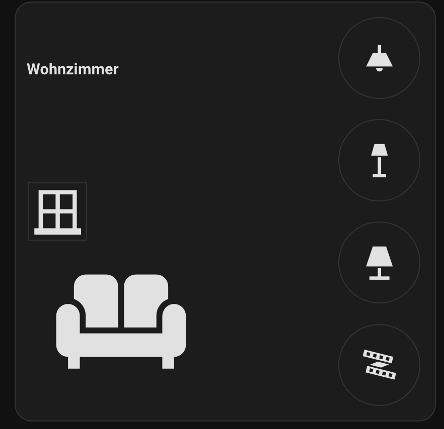

Hi Thank you very much for the great work. I only discovered it today and am currently testing it a bit.
Apparently I don’t get any colors. not even when I turn on the lamps. Can someone take a look at what’s going wrong here?

ui-lovelace.yaml:
button_card_templates: !include_dir_merge_named "../../custom_components/ui_lovelace_minimalist/__ui_minimalist__/ulm_templates/"
title: "UI Lovelace Minimalist"
theme: "minimalist-desktop"
background: "var(--background-image)"
# views: !include_dir_merge_list "views/"
views:
  - !include home/main.yaml
Edit: Ok, got the sensors and entities in color, but the room card itself not. :frowning:
here the actual code I am using →
home/main.yaml:
  # Wohnzimmer Card
  - type: custom:button-card
    #view_layout:
    #  grid-area: room1
    template:
      - custom_card_andyblac_room
    icon: mdi:sofa
    tap_action:
      action: navigate
      navigation_path: living
    variables:
      ulm_custom_card_andyblac_room_color: red
      ulm_custom_card_andyblac_room_color_on: true
      #sensor_label_1: sensor.shelly_ht_temperature
      sensor_1:
        entity_id: binary_sensor.mk_wohnzimmer
        icon: mdi:window-closed-variant
        ulm_custom_card_andyblac_room_sensor_color_on: red
      entity_1:
        entity_id: light.shelly_wohnzimmer
        ulm_custom_card_andyblac_room_use_light_color: true
        ulm_custom_card_andyblac_room_icon_color_on: yellow
        icon: mdi:ceiling-light
      entity_2:
        entity_id: light.plugs_01_switch_0
        icon: mdi:floor-lamp
      entity_3:
        entity_id: light.plugs_02_switch_0
        icon: mdi:lamp
      entity_4:
        entity_id: light.steckdose_02
        icon: mdi:led-strip-variant
I tried to play around with these lines:
but cannot get it work.
Edit: ok, got it. Needed to set the theme in my user profile in the frontend of HA.

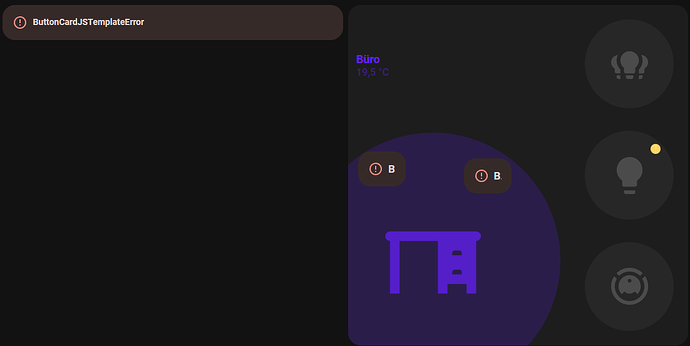

With the latest updates, I got this error. Why?

Hi there,
Since the last update of “UI-Lovelace-Minimalist” to 1.3.19, no card is working with the error “Configuration error”.
It seems it comes from the template “custom_card_andyblac_room”. If I remove the template, the card is displayed (but without all the stuff coming with the andyblac card of course, the error is just gone).
Does anyone has found a way to solve this ?
Thanks
There was an issue thread in button-card repo where the author of that template provided an update.
I made the only available update (UI-Lovelace-Minimalist), but the issue is still there despite the reboot of HA.
I saw a bug report for button-card, but which is now closed without any patch.
So, did I miss something ? Thanks
Did you see this? My Custom Cards for Minimalist UI - #299 by andyblac
Yes I did when it was because of the button-card update. I already applied this fix since many days.
This time, it’s because of the “UI-Lovelace-minimalist” update (to version 1.3.19). Since my first message about this issue, there was new updates of this addon, but none of them fixed this issue.
