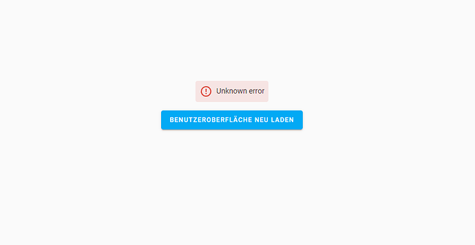

Hello, i have a little problem with the Irrigation System:
The Lovelace Dashboard shows an “Unknown Error” and “Reload UI” right after opening it. So far I haven’t been able to find a solution. The latest HA version is used (2023.7.3).
Does anyone knows an solution for this?
