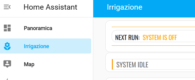

Hi, actually the project is on left menu:
I’d like to change location into this view (actually empty):
How can I do?
Ciao a tutti
I think I followed all the instructions, even if they didn’t always correspond to the exact names of files or locations, currently my condition is this… can anyone kindly tell me where I’m wrong?
Grazie mille

It would be useful as a start to understand what is needed to start the card, as a minimum configuration
I think something is wrong with the graphics but I don’t understand what it could be.
