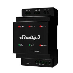

Does anyone know if it’s possible to switch from 3 to 1-phase and back, without having Shell make a permanent change? What happens when you disconnect 2 of the 3 wires from the outlet cable with something like a Shelly Pro 3 Three-phase DIN-relay?
I need to store my solar output, because we are being billed for the amounts returned to the net. My Tesla M3 can go as low as 5A. If i could swap to 1-phase and back, the range for storing solar output would be somewhere between 1150w and 11040w. I can disconnect in between swaps first using Tesla API.

I tried disconnecting phase 2 and 3 going to the charger. Started to act strange, fluctuating amperage, settled at 13A, stopped charging when set at 5A (via Tesla). Disconnecting the wires from the charging cable (going to the car) does work though, stable 16A max.
I’m installing an extra magnetswitch to disable phase 2 and 3 when needed.

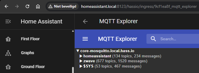

Hi all,
This looks great! I am new to HASS, etc., so please bare with me :slight_smile:
I have installed:
  • HASS
  • NodeRed plugin
  • Mosquitto plugin
  • MQTT explorer
  • The sr-2-50.json Nodered Flow from @35e
But for some reason the flow doesn’t send the MQTT messages:
MQTT does work for zwave and esp-modules but nodered flow doesn’t seem to send any messages:
I have also tried adding a events:all node and configured it using an access token instead of the plugin, but in none of the cases the flow starts sending MQTT messages…
Any thoughts?
Regards,
Nika.
