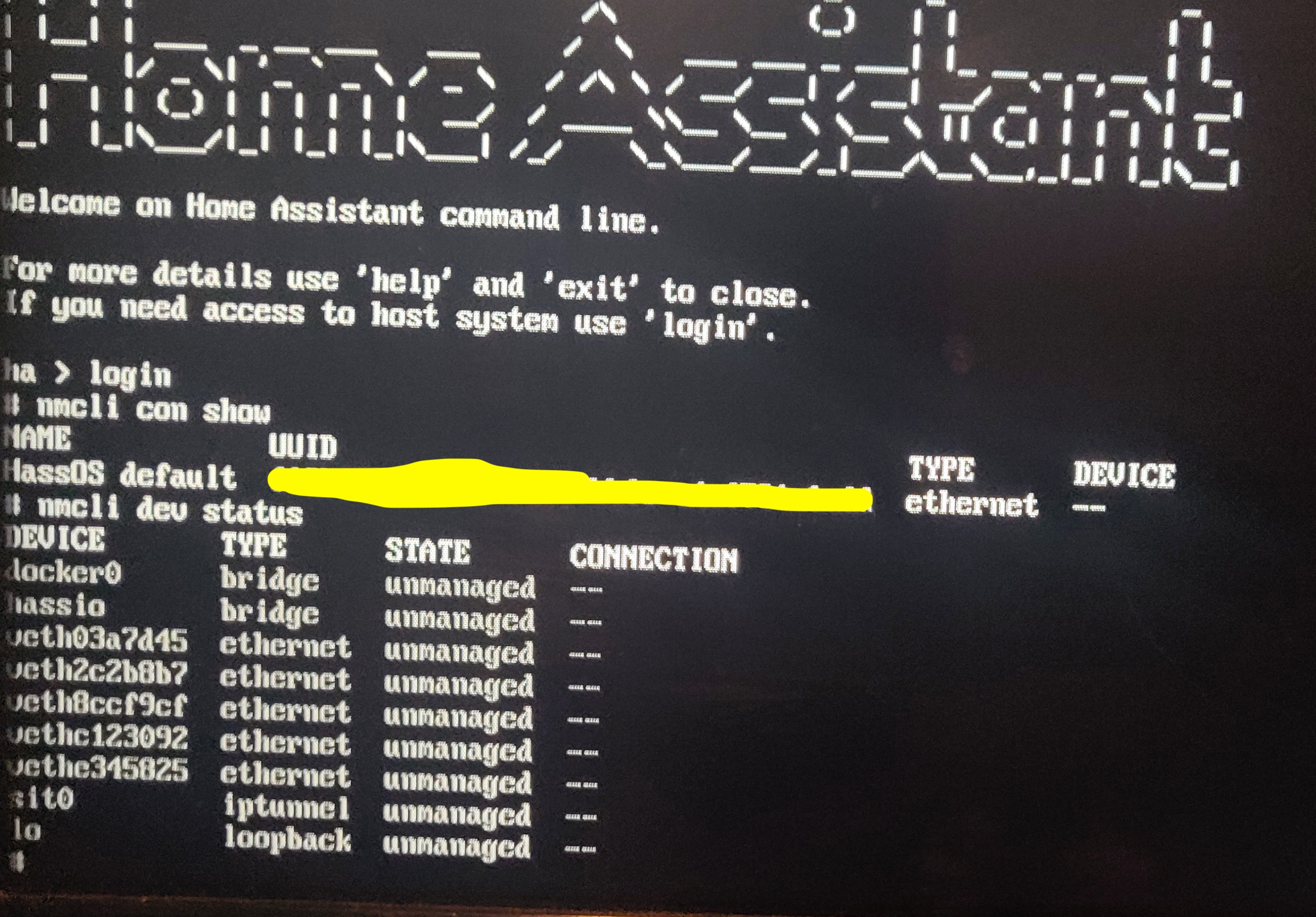

i219-v NIC. NUC10i7, running Hassio 4.8. Not recognizing network/IP address =/
The NUC is on my desk, SSD drive inside. No usb/sata adapter at hand, can’t use balena and will try gparted method. How/when can I set the fixed IP address for hassio?
Mines not even giving me a IP address. Which nuc u running
NUC 10

At this point, I’m having connectivity issues with http://hassio.local.8123 which worked on PI and VM. I attempted to edit the nmcli config based on T.H.U. recommendations for VM, notably connection to my router and rbpi’s old ip address(I’ve reused this ip address before so I’m doubting it’s a router issue). Something I did in nmcli bricked the device w/ blackscreen w/ white underscore requiring a re-flash after multiple attempts. :grimacing:
Could this be to do with some boot setting? - I can’t change my boot priority boot type from UEFI like in Intel’s OpenElec documentation as recommended somewhere in the community. UPDATE I attempted legacy boot but this failed to recognize my SSD.
If this is a new install, HA is available at http://homeassistant.local:8123 and no more at hassio.local:8123
Thanks tried this too, doesn’t connect.
Are you getting a IP address? Ive just said 2 posts up that the NIC in the NUC10 is not supported
Thanks for letting me know.
I haven’t been able to get an assigned ip or any network connection, but now no NIC support on NUC 10 makes sense.
