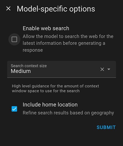

Go into your OAI integration you’ll see your conversation agents listed.
For the one you want to edit, lick the gear icon to edit it’s config.
In the resulting dialog scroll tk the bottom and here I unchecked use recommended settings. Then Submit.

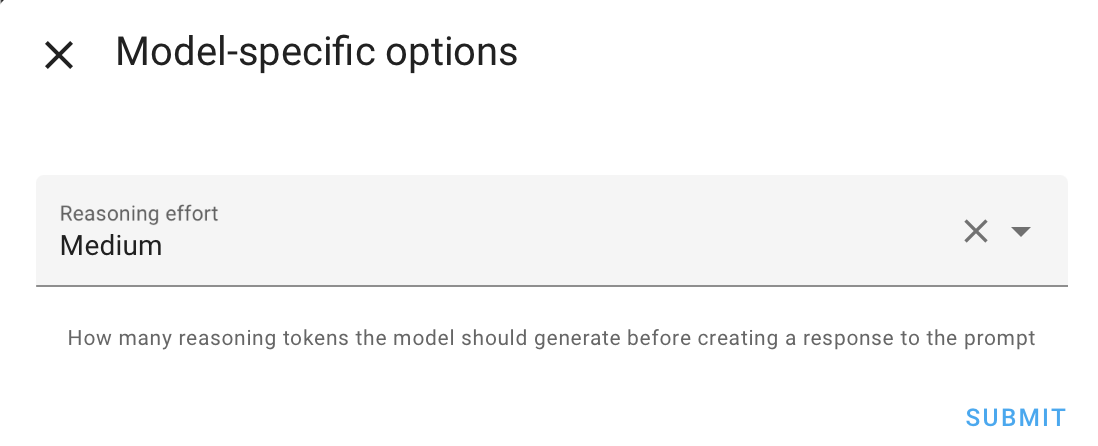

Next pick your model, options, etc, submit
Aaaand there it is.
Buried deeeep.

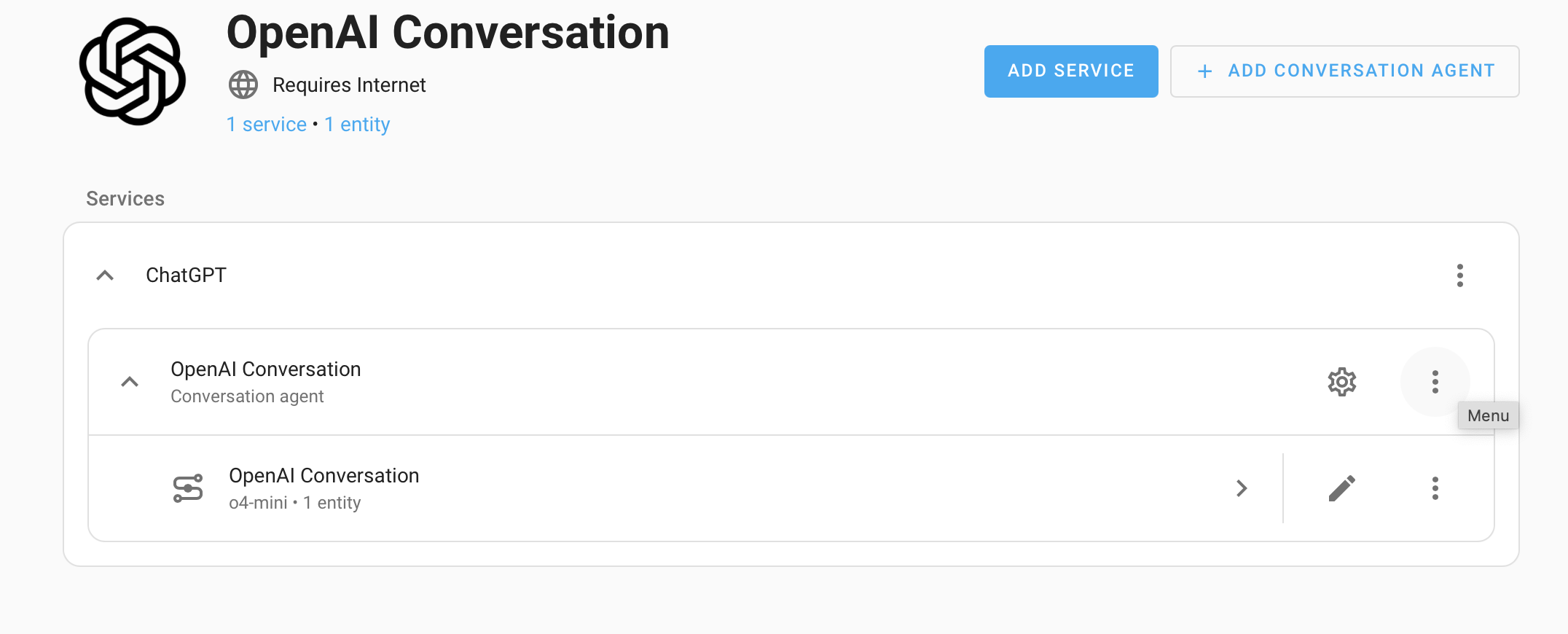

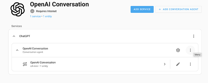

I only get this option
Im using OpenAI Conversation, is that the correct one to use?
This is the OAI integration Im using:

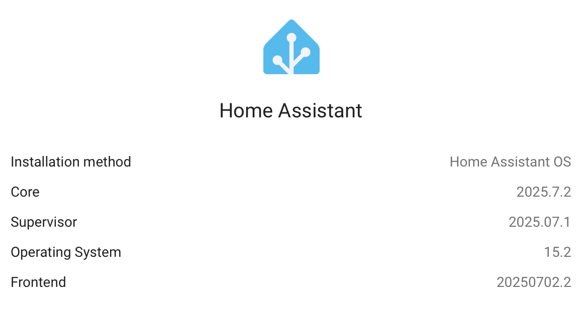

Is your installation up to date?
There have been a lot improvements to Assist and LLMs in the past months/year.
Access to scripts might also not work otherwise.
Yes it should be, there are no updates available
Ah, why do they name all their models so similar. :face_with_monocle:
Missed it on your screenshot.
You selected o4-mini wich is a more expensive reasoning model and has no websearch.
The default model is gpt-4o-mini and has the option for web search.
You’re correct and was about to say the same model matersy… I believe GPT4.1-mini and maybe nano support it as well.
