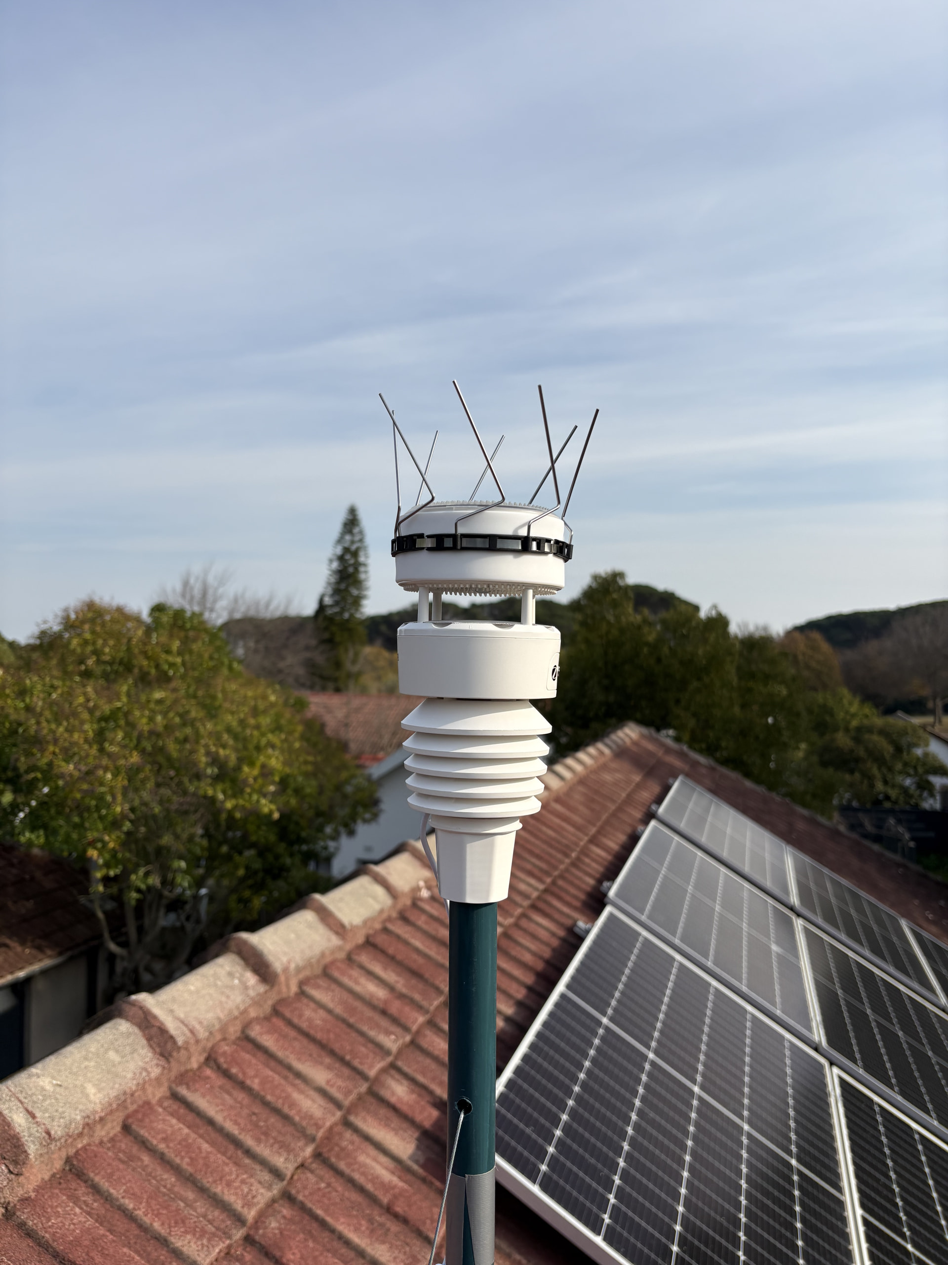

Mounting it
This part spanned months, because we have a toddler at home and finding a contiguous couple of hours over a weekend to do some ad hoc shopping and trying ideas can be challenging.
Our house has a 25° tile roof with no directly exposed vertical face anywhere useful (soffits all around), and the garden is full of large trees. While an L-bracket could be mounted, it would’ve had to be several meters tall to portrude above the roof’s ridge for proper clearance.
I searched for ridge mounts and found nothing locally. I looked at antenna mounts and dish brackets. I looked at Starlink roof mounts. I contacted local antenna installers, and nobody had a solid idea.

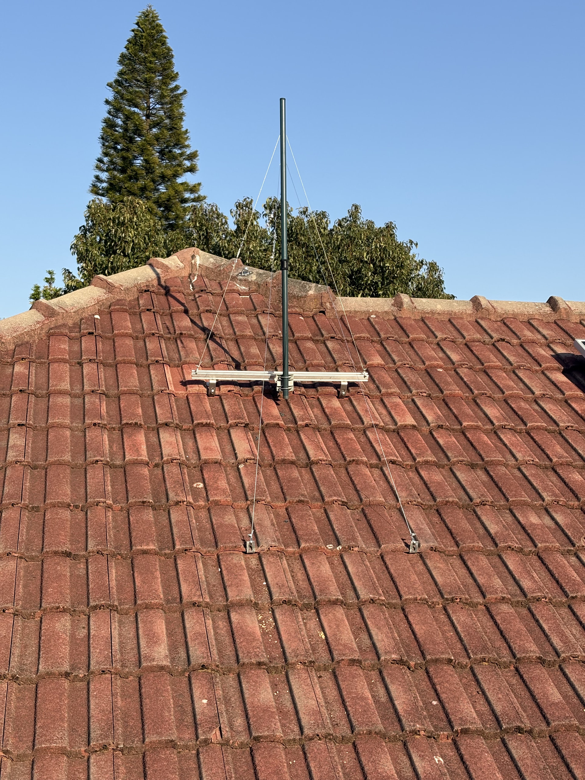

My first attempt was two solar mounts with a solar rail and an adjustable antenna mount with U-bolts.
Installing it meant moving roof tiles around like a sliding puzzle (some are fixed with nails, and you don’t know which, plus you need to find ones that will expose the rafters), grinding a couple for clearance, and losing most of the skin on my hands until I bought some gloves. At that point I felt qualified to install my own solar panels.
Unfortunately, this turned out to be an excellent pendulum.
I tried to move the vertical mount to the sides (closer to the solar mounts). I tried rigid members to form triangles, but that only removed one axis/degree of freedom. I felt a bit embarrassed, but first-year engineering statics is more than 25 years ago now, and I’m an electronic/electrical engineer anyway (by qualification, at least).
I also didn’t want to end up with something unsightly. I knew my only real option was to install more solar mounts to anchor some guy wires. It turned out solid and has withstood a couple of windstorms by now.
Final BOM:
  • 4 solar clamps, and a rig bracket fixed to the ridge
  • 1 piece solar rail (about 1m, I think)
  • an adjustable antenna mount (typically used with Yagi antennas)
  • PVC irrigation pipe as the mast, far lighter than steel and more than strong enough
  • guy wires, tensioners and anchors
Solar rail across the ridge, adjustable antenna mount, irrigation-pipe mast.

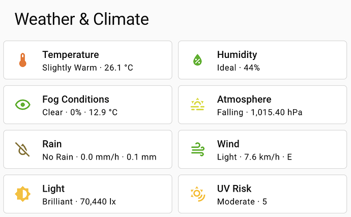

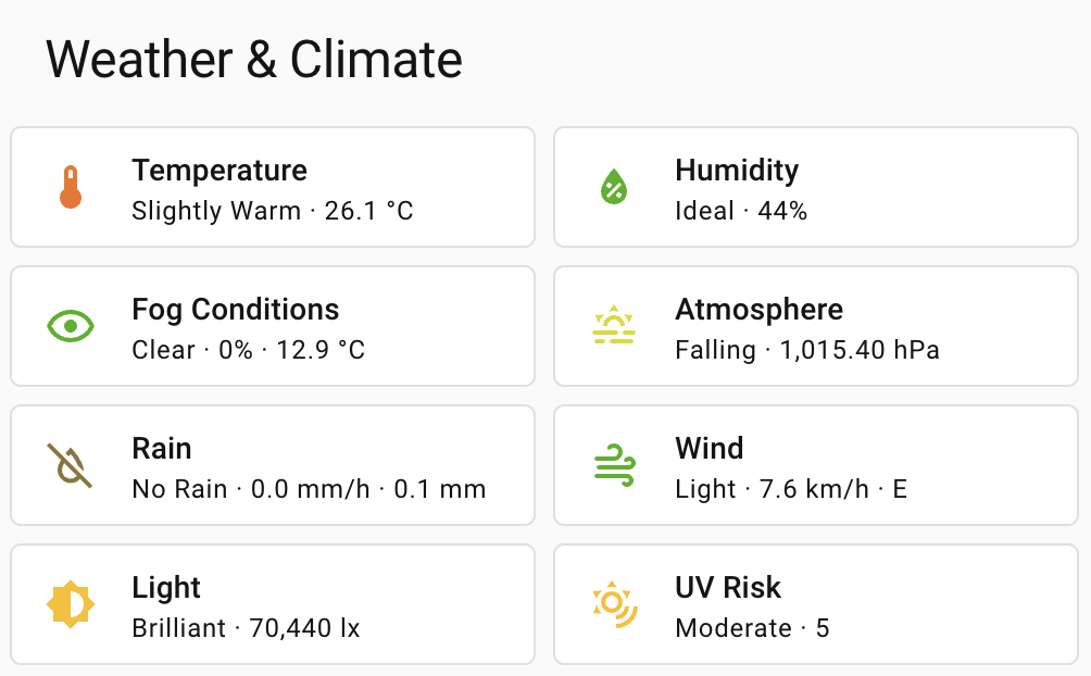

The dashboard
Eight standard tile cards. The whole design principle is to provide the human label first and numbers second: “Slightly Warm · 26.1 °C” and not just “26.1 °C”.
- type: tile
  entity: sensor.wind_condition_beaufort
  state_content:
    - label
    - wind_speed_with_unit
    - compass_direction
  tap_action:
    action: more-info
    entity: sensor.wind_speed_filtered_km_h
Note tap_action pointing elsewhere: the tile displays the interpreted condition, but tapping it opens the history of the underlying measurement, which is what you actually want to look at.
Icon colours come from a shared gradient macro library, so temperature, UV, wind, pressure and rain rate all colour consistently. Rain rate and illuminance use a log10 scale, since both span four orders of magnitude and a linear gradient wastes its whole range on the top decade. The uix: blocks you will see in my YAML are card customisations.
Behind the tiles, the detail lives in fold-out rows.
