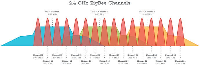

Without re-reading that post that I linked, the only other thing that I tweaked on my network after having issues was the channel. Scan your neighbourhood WiFi channels and choose a new Zigbee one depending on that.
