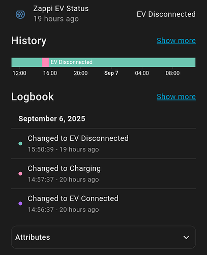

There is a lot to learn in Home Assistant and template helpers are not the easiest thing. I recommend getting familiar with the history and logbook functionality of home assistant using the HA documentation and community cookbook.
This should show you the various entities and their states when charging or not charging. I use ā€œsensor.zappi_charger_statusā€. I might have renamed the entity, so your entity can have a different name.

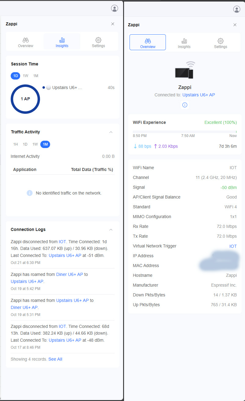

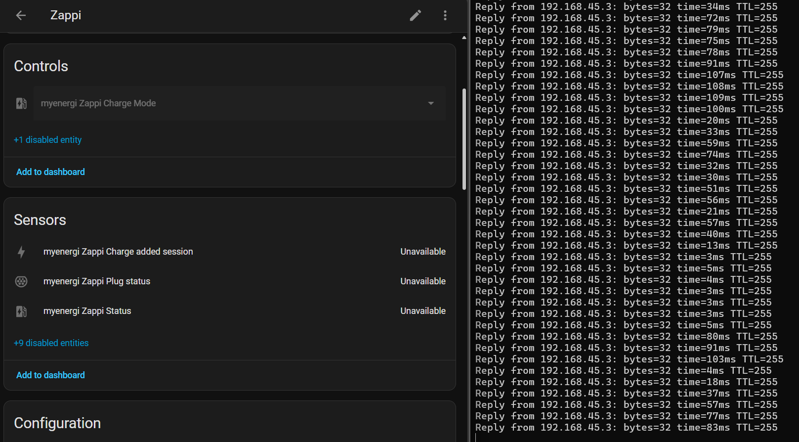

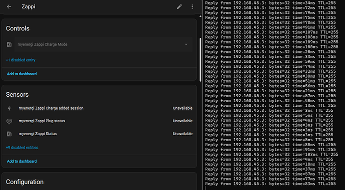

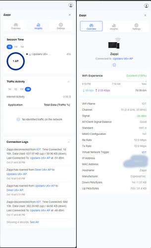

Does anyone else have issues with their Zappi status changing to unavailable? You can see this is happening a lot when I look in my logbook or at a status history, lots of black lines showing where it went unavailable. It’s messing with some of my automations.
I’m running Home Assistant in a docker container.
I don’t recall seeing an issue for this. Could it be a local network issue?
I’m running a Unifi setup. I have 2 Access points that are both within range and the network connectivity is not showing any concerns on the Unifi management software. Maybe I need to try myenergi support.
Unifi should be able to tell you how long a device is connected and connection quality.
You can also try Uptime Kuma - Home Assistant with the HA add-on for more detailed monitoring.
it’s not showing any disconnections other than the dates when I was installing a new access point and updating the software on the network switch.
I left a ping running and monitored it when the zappi went to ā€˜unavailable’ and there was no loss of ping packets.
