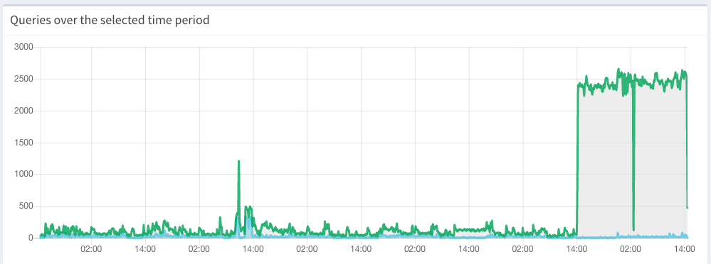

I have a similar problem to this but the resolution works fine. What I’m curious about is the sheer amount of DNS queries being made by my HA instance running through Hassio on an RPi. It keeps making queries for domains with in-addr.arpa in the name. For example:
42.1.168.192.in-addr.arpa
The queries are relentless and I’m not sure where to start to try and debug this.
Edit: Apparently this isn’t an issue per this GitHub issue, but it’s very odd that the spike started all of a sudden considering it wasn’t happening before.
They are reverse dns lookups.
