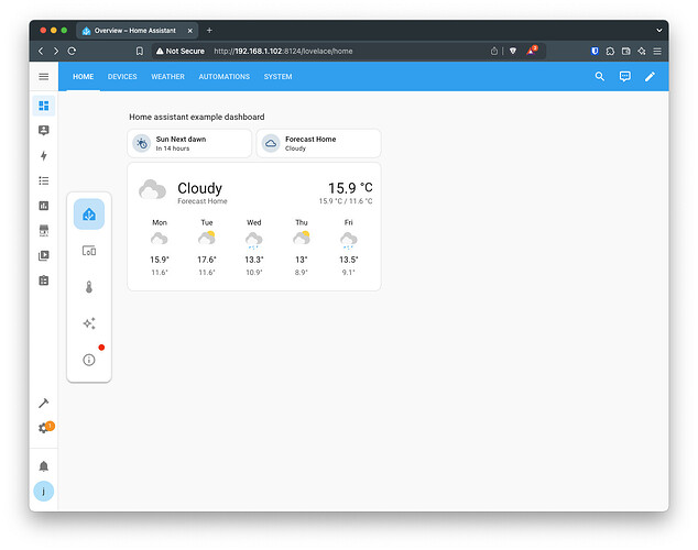

I just released a new custom card called Navbar Card. It’s a responsive navigation bar for your Home Assistant dashboards, heavily inspired by Adaptive Mushroom. It adapts to both mobile and desktop views, making navigation smoother.
I’ll leave the link to the repo here along with a couple of screenshots.
Mobile view:
Desktop view:
Give it a try and let me know your thoughts!
Cheers, Jose
