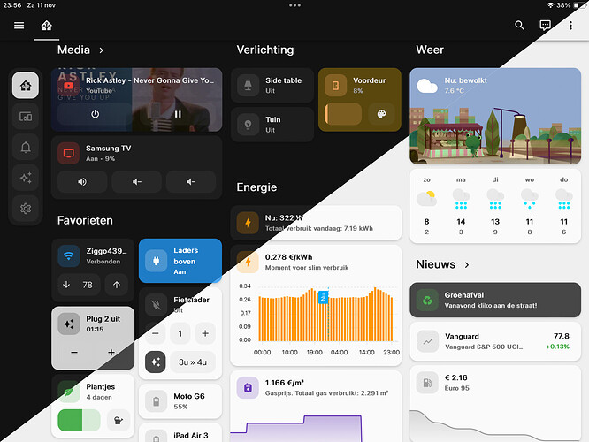

I wanted to be able to have a nice, modern mobile layout like in 7ahang's design, while also making use of the full screen on tablet/desktop. Having both in one dashboard meant I could do quick edits on cards without having to copy them to another dashboard. After much trial and error, nitpicking and YAML syntax errors, I ended up with my current dashboard that you see below.
Screenshots and features
  • The amazing layout-card is used to make the layout adaptive for mobile/tablet/desktop.
  • The mobile layout features a bottom navigation bar inspired by Android material design; the tablet/desktop layout has an easily accessible menu on the left of the three columns.
  • Custom theme variables are used for light/dark mode support.
  • I mainly use Mushroom cards, but I also made several custom cards using for example button-card.

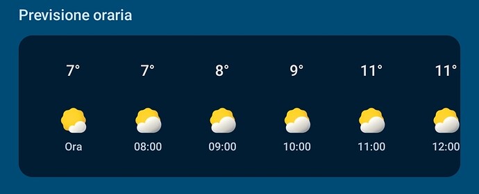

Alright, so onwards to today’s edit. Got this working fully on openweathermap incl. adjusting the time towards noon.
20/11: updated
Changed the rain sensor and added better icon depending on the possibility of MM snow fall.
@ArenaCloser please note you use two differnt statments for classifying rain. The amount of ml is not matching for weather_now / weather_day.

I see what you guys mean now. Indeed for the 5-day forecast card I use the Buienradar integration, because it provides a daily forecast for the next 5 days. If you have another integration, the code has to be adjusted for that a little.
I believe you can use OpenWeatherMap in daily mode, which would be an international alternative option for this card. I use hourly mode, so my sensors may be slightly different (I only get up to 48 hours of forecasts). But here’s some code to get started for OWM:

            http://www.gstatic.com/images/icons/material/apps/weather/2x/{{slug}}_light_color_96dp.png
          primary: '{{ state_attr(entity, "forecast")[[[index]]].temperature }},'
          secondary: >-
            {{ as_timestamp(state_attr(entity, "forecast")[[[index]]].datetime)
            | timestamp_custom("%H:%M") }}
          multiline_secondary: true
          card_mod:
            style: |
              ha-card {
                box-shadow: none;
                background: none;
Card
type: custom:stack-in-card
mode: horizontal
cards:
  - type: custom:decluttering-card
    template: weather_owm_template
    variables:
      - index: 0
    variables:
      - index: 24
    variables:
      - index: 47
Results in this:

I use hourly and I have 7 days of forecasts in Italy. With @mysob’s card I solved everything
@ArenaCloser I’ve updated the code. It should now correctly present the 5 day ahead from 13h. Also changed the http in https, for correctly displaying the icons when using HA cloud.
Feel free to add it. I use the official OWM integration, nothing had been adjusted there. The standard plan includes the 5 day ahead:
@Mattia2399 please note I did update the code. :slight_smile:
