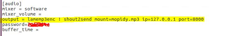

Uncomment the AUDIO Section and change OUTPUT to “output = lamemp3enc ! shout2send mount=mopidy.mp3 ip=127.0.0.1 port=8000”
Add Icecast2 password to this section (default is hackme)

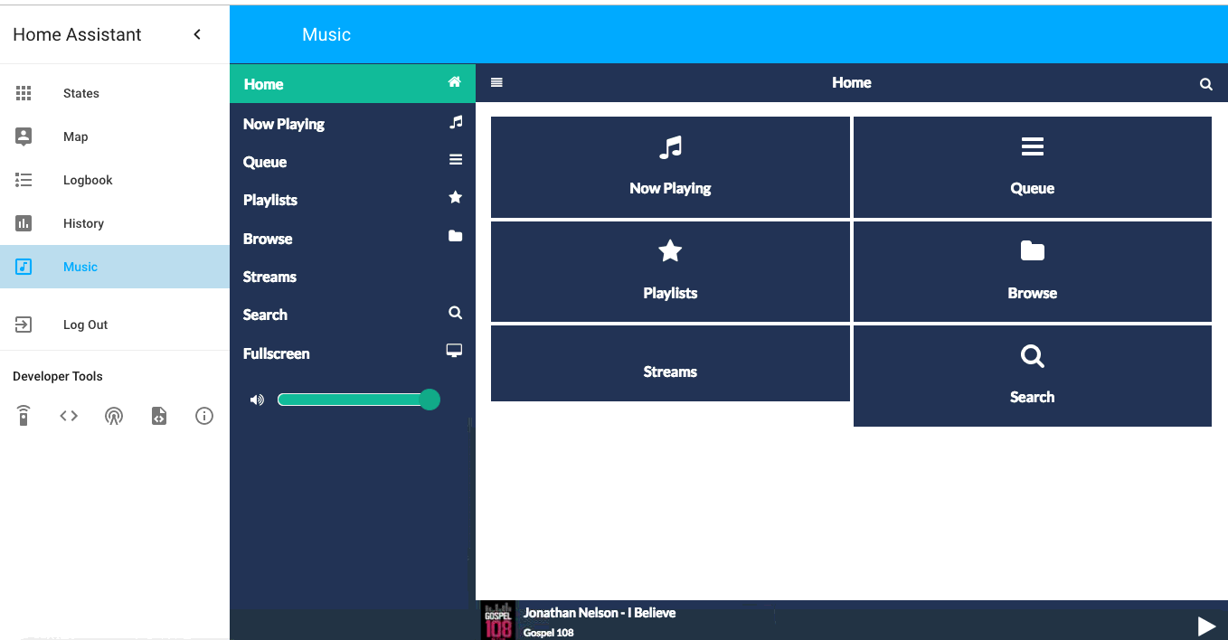

Iframe:
Now that you have a webclient for Mopidy we need to add it to Iframe in HASS. Now your iframe will be on the left side of HASS, You can now play from this section. Once you play music from this section you will need to tell it which speakers to go to by activating one of your switches.
This is the best way that I have found to do this so far. It may not be ideal for everyone but it seems to be working relatively well. I am currently working on a custom panel to see if I can get the chromecast stream switches right above the WebApp. Lets hope it works lol.

Im jjust trying to configure this, ice cast is running, ive made the config changes, however when i run mopidy i get the following error (only when i put password in though)
WARNING Found fatal audio configuration errors:
WARNING audio/username unknown config key. (tried with and without username option)
WARNING audio/password unknown config key.
Config
[audio]
mixer = software
mixer_volume =
output = lamemp3enc ! shout2send mount=mopidy.mp3 ip=192.168.5.232 port=8000
username = relay
password = whatiset during icecast install (checked in config file)
#buffer_time =
Also if i dont set password, mopidy starts but when i try and play a file or stream i get the following error
ERROR GStreamer error: gst-resource-error-quark: Could not connect to server (6)
Any thoughts would be appreciated?
