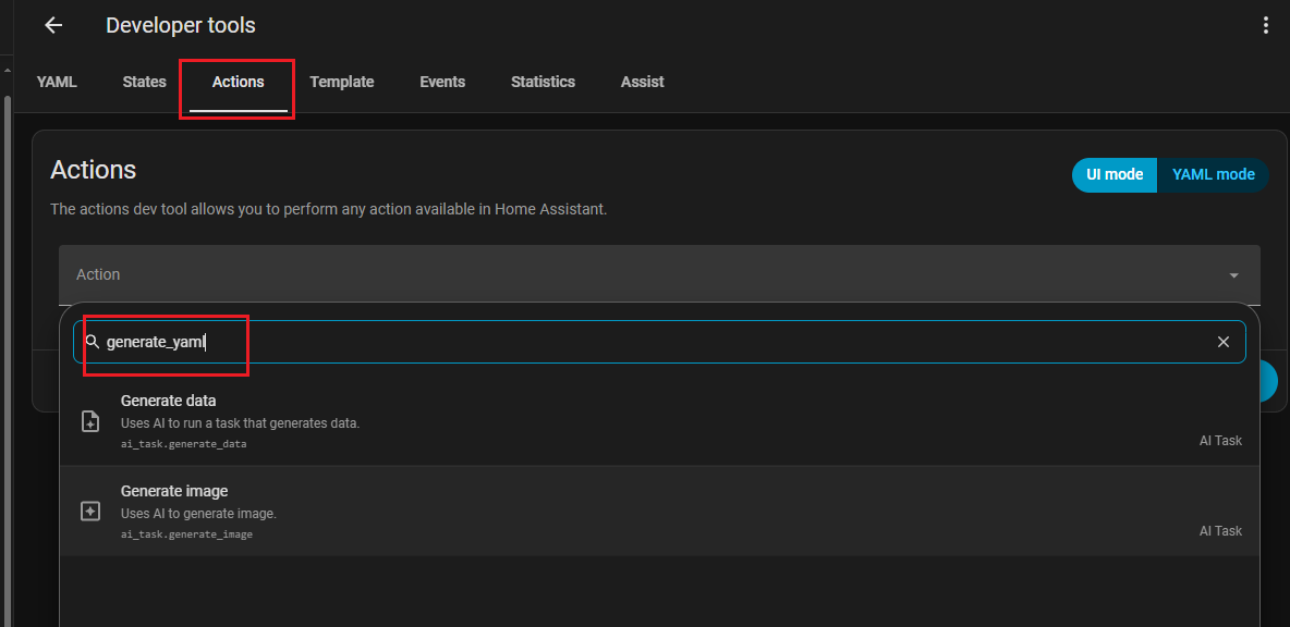

  1. Removal of legacy template entities in 2026.6 - stuck as I don't find any template_migration.generate_yaml

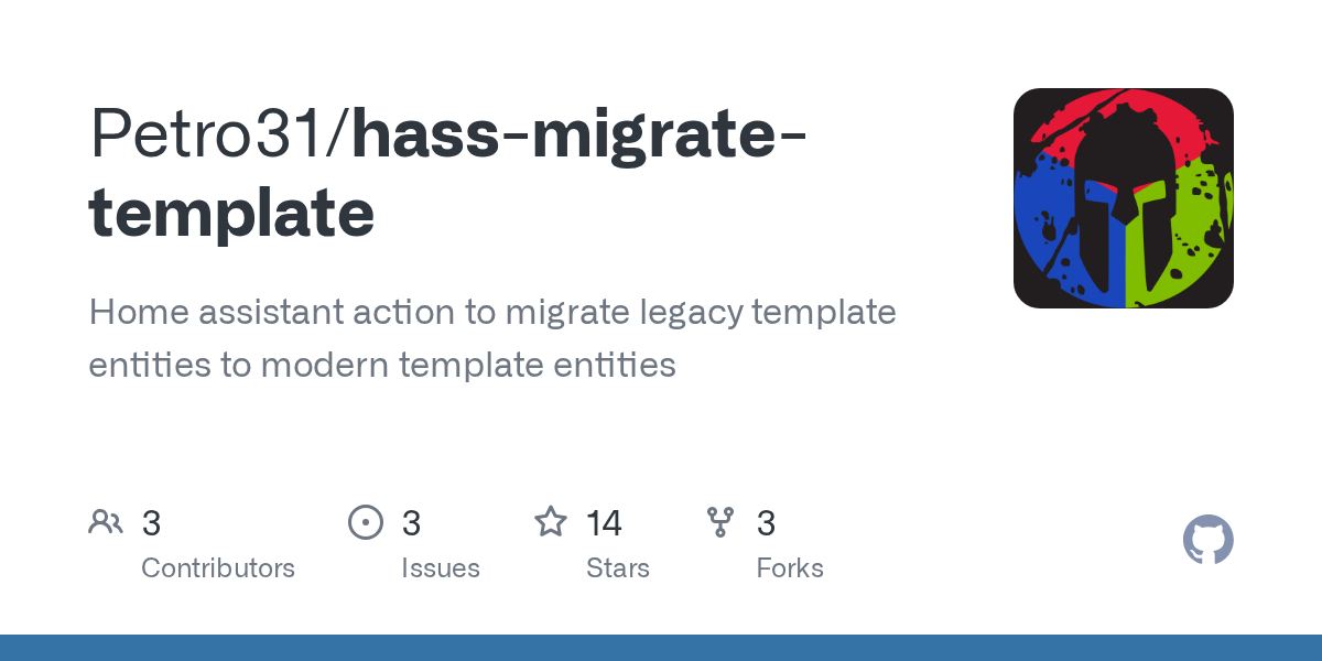

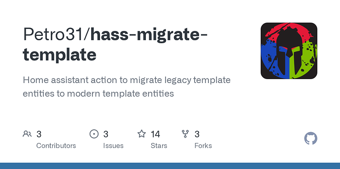

That's not a valid configuration variable.
You need to add the template migration via HACS, using the 3 dots in upper right, custom repositories.
That is why you don't see it
done and rebooted, still nothing
UPDATE
  • appeared after I further added in integration
  • problem solved after successful migration
