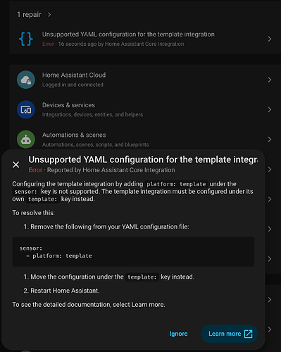

I am sorry if I am being really thick headed but I am confused. I just updated to 2026.6.0 and I have a repair for "Unsupported YAML configuration for the template integration". It tells me to remove anything that is:
sensor:
  - platform: template
In my configuration.yaml file I have several "include:" lines. One for "binary_sensors.yaml", one for "sensors.yaml", and one for templates.yaml. There are no templates defined in binary_sensors.yaml or sensors.yaml. All templates are defined in templates.yaml. Within the templates.yaml file I have several under the keyword sensor: and one under the keyword binary_sensor:. All are producing a state in developer tools.
If these are in my configuration file as "template: !include templates.yaml" why am I getting the repair notice?
Please use the migration utility.
If you're getting a repair, you have a legacay template somewhere in your configuration.
Are you using packages?
Running the migration utility and following your instructions fixed it. It was a template setup in the weather_alerts_1 as part of the old weather alerts integration. They refactored that when this template entity change was beginning. I didn't realize that the old one was still on the system. Do I need to keep the template migration: !include in my configuration.yaml now that I have deleted that weather_alerts_1 sensor?
