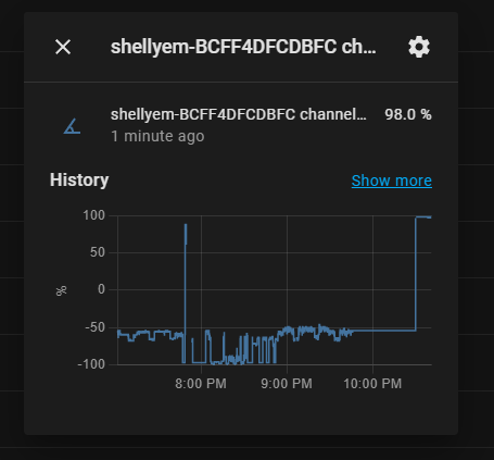

Hello. I just configured a Shelly EM which correctly shows a positive power factor on its homepage. Home Assistant, however, for some reason reports the value as a negative number. Both the voltage and the power are positive, as well as all the values reported by Shelly at its webpage. The problem is just on HA, so I think it is a bug.

Update:
So this happened.
Then I made a new full backup and proceeded to restore an old backup. Then none of my addons worked anymore. So I restored the new backup (made after all the bugs) and surprise… both bugs are fixed. The percentage is positive and the energy panel is working again.
![pfchart](https://community-assets.home-assistant.io/original/4X/e/f/e/efe154986b33635bf8f37b389dfc7f59f7ea75fc.png)
I did not touch the sensors or any configuration whatsoever.
All the addons refuse to work now though.
Nothing makes sense to me anymore.
And it’s negative again… It oscillates between positive and negative without any apparent sense. Shelly reports the correct value on the homepage though.

I don’t normally use the power factor sensor but just checked and I am also seeing this behaviour.
EDIT: Checking further this actually seems to be an issue with the Shelly firmware. It is reporting:
Also the integration is changing the units (to %) which is a no-no.
So the negative number needs to be taken up with Shelly support not Home Assistant. Ignore my suggestion to report the issue above. Unless you want to report the change of units.

Because it is clearly the Shelly firmware as shown by what their API reports:
By shelly app I mean the APK for the phone.
The APK shows the power factor with a negative value.
If we look with the browser, typing the IP of the shelly, it shows the same value but with the positive value.
And if you look at the results from the API, which is what home assistant uses, it is negative. So it is an issue with the firmware.
Agreed. Raised with Shelly Tech Support. They’ve confirmed the issue and have indicated that a fix is planned, but haven’t given a timescale.
