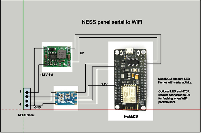

I did a lash up diagram in case anyone else wants to try a WiFi solution.
I have just flashed the NodeMCU with the JeeLabs standard binary from the original creator found on GitHub.
https://github.com/jeelabs/esp-link/releases/tag/v2.2.3
There is a branch here than may be better now. I was hoping they’d implement an option for logic inversion so I could dispense with the RS232<->TTL module (logic voltages seem compatible out of the NESS panel).
https://github.com/Stef-aap/RFLink-ESP

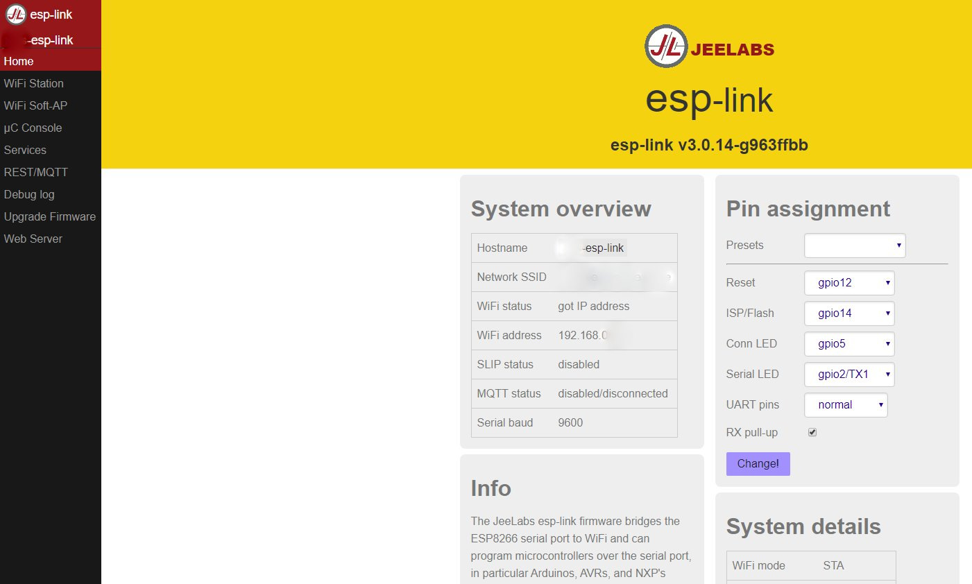

This is my ESPlink web server accessed configuration in the web browser GUI. My Wifi and IP info has been masked out…

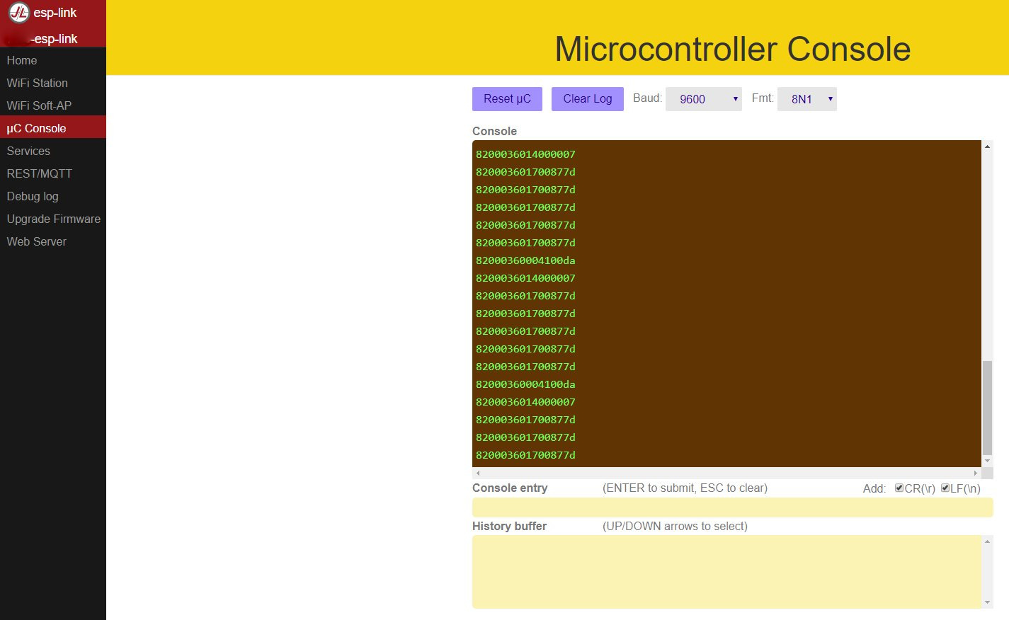

The very handy real time serial console via the web server GUI.
