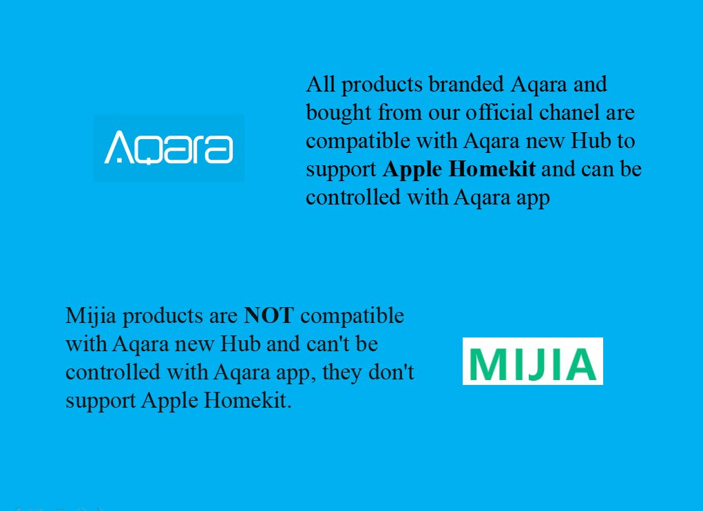

New version of Hub is complatible with HomeKit.
Unfortunatelly Mijia products are NOT compatible with Aqara new Hub
