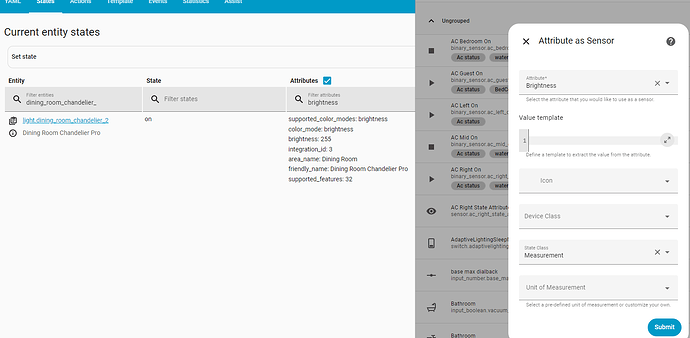

giving this a shot… seems like it would be useful rather than having to whip out yaml files for this…
accuweather doesn’t have a humidity entity, so hoping this will solve that problem from the weather.accuweather device
UPDATE: This is awesome!.. thanks for making this @gjohansson

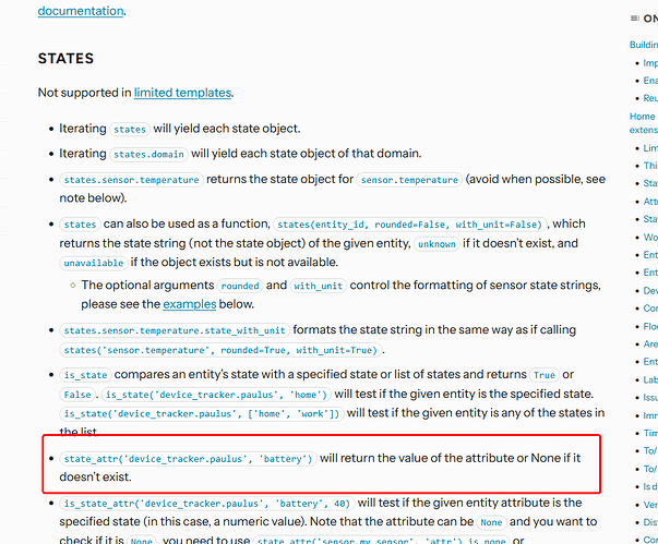

How do you reference the attribute in the template? IE here I’d like to take brightness and devide it by 255 then times 100 to get a percentage.
