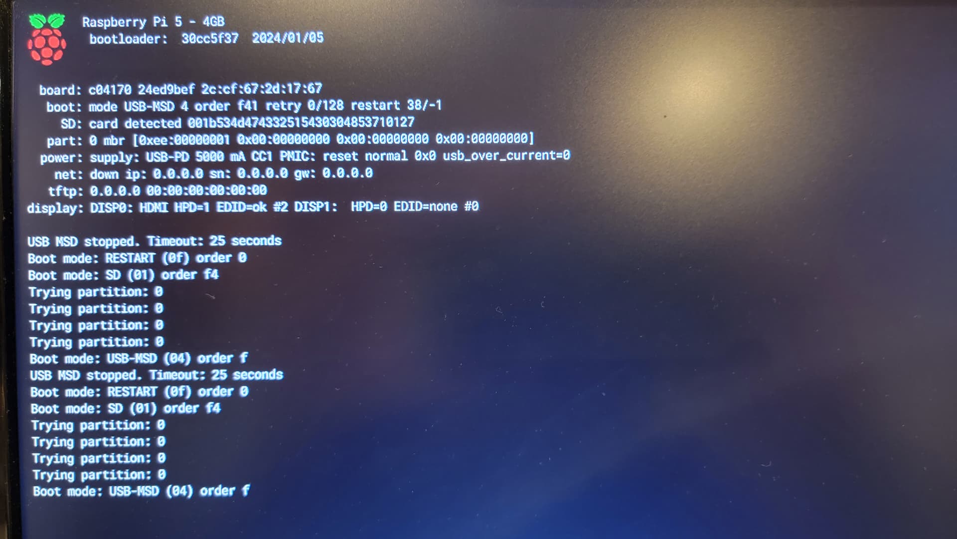

I install the SD card to the RPi5. It’s connected to my ethernet. I have an HDMI monitor connected as well to watch what it does.
I apply power and it begins the boot up process but seems to get stuck in an endless loop retrying.
Perhaps this screenshot can give a clue. Note that I’ve tried re-flashing the SD and even used a SD card from a different manufacture. The results are the same.
What have I done wrong?
what i get is The RPi is seeing the SD card, but cannot find a valid bootable partition
perhaps your image on the sdcard is corrupted, try to make a new one

try with this
get the las recovery image
watch the LED flash pattern after about 30 seconds, it should stop blinking update complete
and try again with version 15.2
the 16 is causing crash all over diferent systems on yellow and rpi something with eeprom
try with a different version of hass
also you can try instead of a sdcard use a USB, i dont have a rpi5 but as far as i remember you can boot on usb without modifications
I did the first part as you suggested. It continued to blink for much longer than 30 seconds. After 5 minutes of waiting I removed power to restart and hoped I didn’t just brick it.
When I gave it power back with no SD card there was no output on the HDMI port, so I got mighty nervous.
I powered down again and put the SD card back that had the version 16.0 of HA and by some magic it fired up, complete with the welcome screen on a browser going to homeassistant.local.8123
