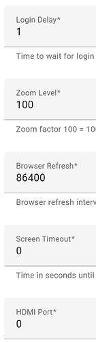

I’ve had similar mistakes. Try this configuration:
