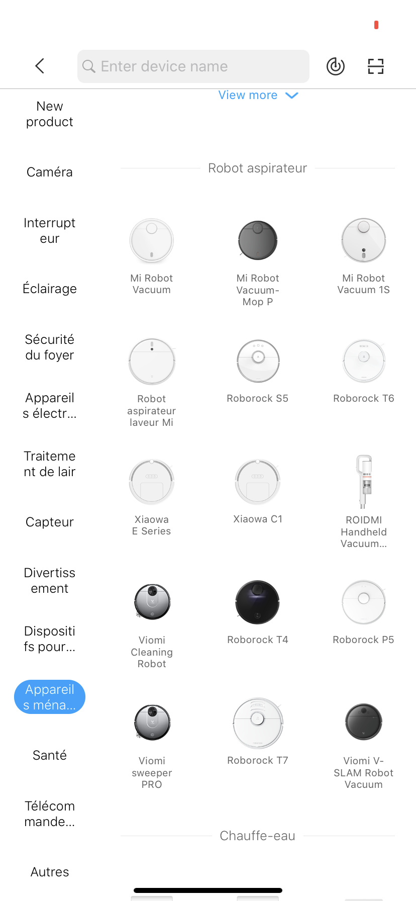

I know have the Roborock S5 Max … It looks like I have to use the Roborock app, I can’t see the S5 Max on the device list of the Mi Home app. @fitim how did you connect your S5 max on Mi Home ?
Thanks a lot mates
I don’t know how you mean this. In the same way you add it to Roborock app, you can add it to Mi Home App. There was no difference …
As tou can see on the Mi Home app, no S5 max device on the list. Did you gad the S5 Max on the list when you added your vacuum cleaner on the app ?
I can’t say 100%, buz I’m 99% sure that there was a S5 Max for me. Maybe you should use an older version of the app.

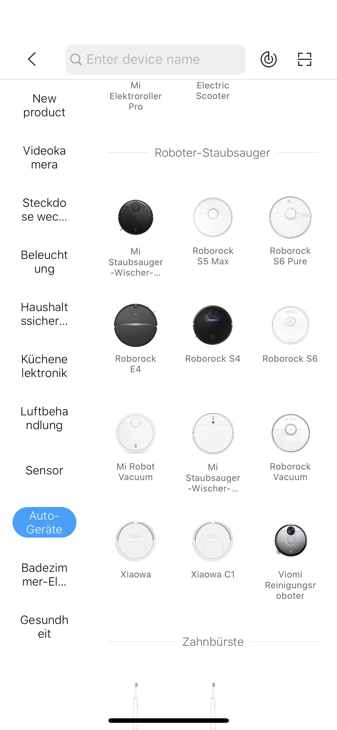

I just checked again, I still have the option to select. Check out the screenshot:
I‘m using the app version 4.28.3 on iOS. I think it also depends on the country that you have chosen for your account. I have Germany ( or Europe).

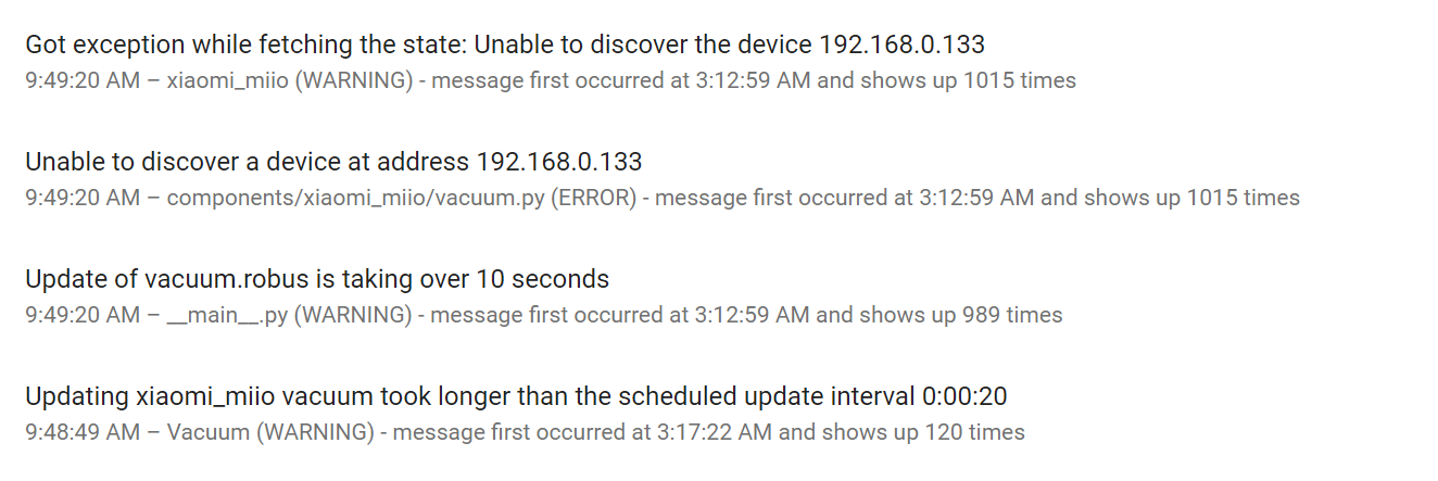

I’m having an issue where HA loses connection to the S5 max - just after 9am every day.
I think the token is resetting itself at this time every day. I’m also running rrcc and the token stops working in that as well as HA so I’m pretty sure it’s this. Any one else had this? Managed to overcome it?
If I reset the wifi and go through the token extraction process, everything works great from HA again, but 9am the next morning, it all stops. I’ve even tried blocking the device from internet access in case it’s something cloud related, but that had no effect.
These are the only errors I get
Update of vacuum.xiaomi_vacuum_cleaner is taking over 10 seconds
9:13:11 AM – __main__.py (WARNING) - message first occurred at 9:09:21 AM and shows up 12 times
Got exception while fetching the state: No response from the device
9:13:00 AM – xiaomi_miio (WARNING) - message first occurred at 9:08:48 AM and shows up 12 times
Got error when receiving: timed out
9:13:00 AM – components/xiaomi_miio/vacuum.py (ERROR) - message first occurred at 9:08:48 AM and shows up 12 times
