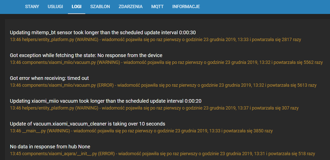

Here is also my logs:
[EDIT]
Strange thing - I double checked the token and it changed from the last time . I edited it again and viola!
It works in HA
