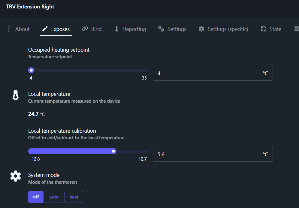

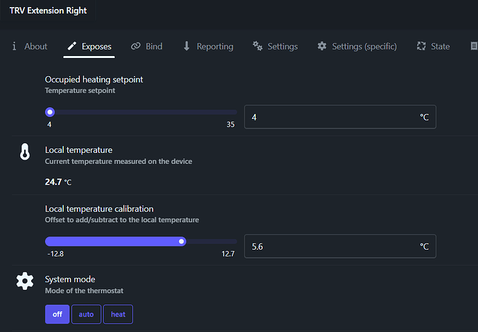

I just updated mine (10 of them) and the “Local temperature calibration” is still there - am I missing something?
no, @FaneUniv is :smiley:

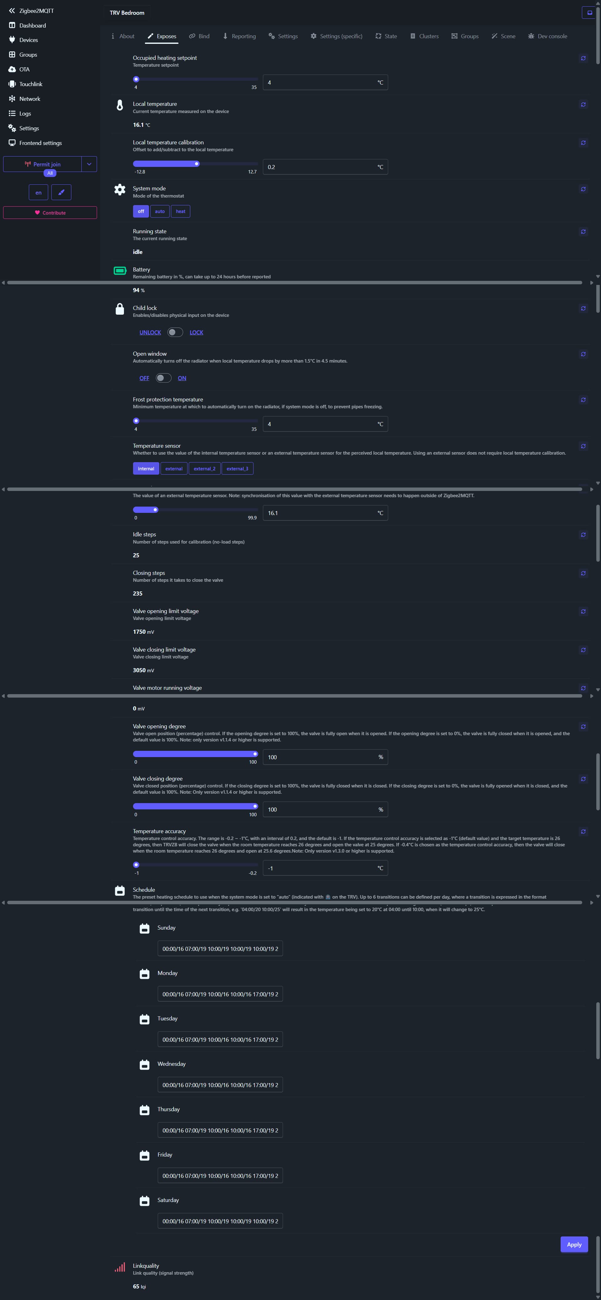

So, at least for @SaaX, it behaves like it should. Can you please share a screenshot with the new temporary mode?
@LittleBro I would if I’d know where to look.
So it’s not there (yet). I guess it needs to be added to Z2M as well for it to be exposed.
I also updated to version 1.4 and everything works as expected.
I also have the temperature calibration there.
yea, upgraded 1/6. the calibration is there, the new modes are not.
