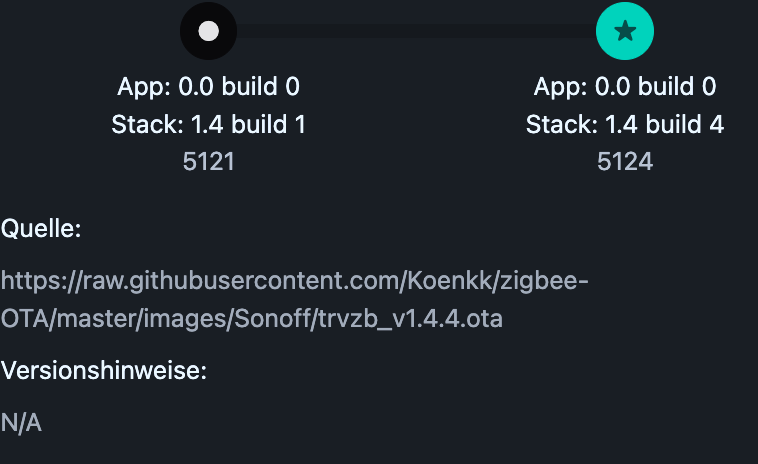

New Sonoff TRV firmware
v.1.4.4 was released and ready for OTA - does anyone have a changelog as the update notice remained empty
The pull request on z2m that introduces firmware 1.4.4 states:
  • introduces Smart Temperature Control feature
  • includes stability improvements / minor fixes
Sonoff has official release notes for 1.4.4 that mentions changes to ‘Adaptive Mode’
